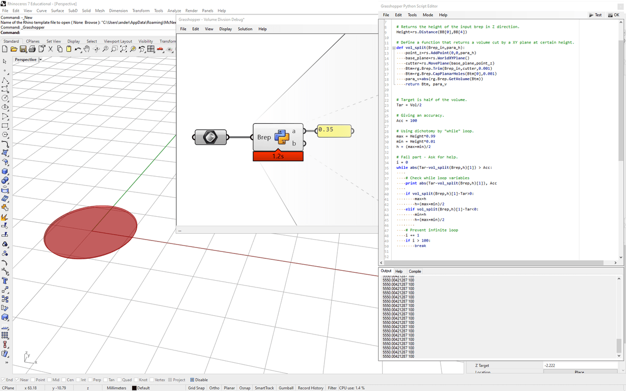

Hi John, welcome onboard. It’s easier to help debug if you upload a Grasshopper definition with all relevant geometry inputs internalised and a screenshot of the error message/stack trace. Very nice source code formatting though :slight_smile:

Edit: I didn’t notice you had commented out the offending bits of code (using """" some code """ will highlight properly). Looks like you’re never meeting a condition that will end the while loop (i.e. you enter an infinite loop and crash Rhino). You can prevent this by explicitly breaking the loop after N iterations, enabling you to debug why. In this case, your volume variable never drops below 5550:
Volume Divsion Debug_AHD.gh (5.0 KB)

The reason is that the varaible “Btm” (surface) in function “vol_split” is flipped unexpectedly. As a result, the variable “Vol” and “Tar” turn to be negative numbers, which makes the while loop doesn’t work.
One of the solution is to change " Tar = Vol/2 " to " Tar = abs (Vol/2) "
With this change, the while loop works well (no need the break condition).
