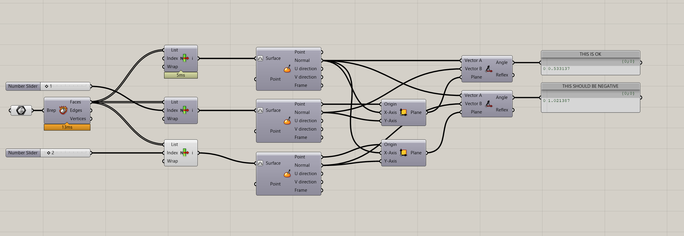

I’m not sure, but - after playing around with vectors - it looks like the angle between two vectors will always be given as a positive.
With that in mind, the only thing I could think of was to compare the origin points of the two surfaces being compared. If the Z of the origin of the first plane is larger than the Z of the origin of second plane, then make the angle negative.
Bending_Angles_Forum2.gh (12.2 KB)
(Edit)
Conceptually, it might be easier to think of it the other way…if the Z of the origin of the second plane is smaller, then make the angle negative. So in this second one I used the lesser-than components.
Bending_Angles_Forum2b.gh (17.2 KB)

to be fair I’m a bit unsure about that :slight_smile:
let’s say that -without changing any angle between faces in the brep- I just rotate the whole Brep a little bit… reading the Z coordinate doesn’t look like a reliable solution:
@inno I agree, but I think the approach if you make it independent of the z-axis works. At least it worked on the breps I tried it on so far.
In the video, I implemented the code shared before, and I can rotate it as I want; the result stays the same.eo i implemented the code shared before and i can rotate it as i want the result stays the same.
as far as I can understand from your code (I’m more of a Python reader to be honest :upside_down_face: so I could easily be wrong)
that approach is based on the direction of the surface Normals? I’m more about the reliability of that
if you pass your brep through something like this (will flip all the surface normals alltogether)
you might get negative values for what should be an upward angle, and positive values for what should be a downward angle?
