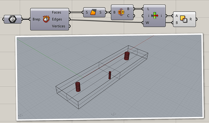

Hi All,
I would like to detect holes in brep. May I know any component or method to extract this. I have attached a sample brep with rectangular cross section. Also cross section wont be box always it may be C shape, W shape so creating bounding box and extracting holes from is not good idea for this. Please help.
detect_holes.gh (6.3 KB)
Here is one idea. I’m not sure it will work for all of your cases.
detect_holes_V2.gh (9.6 KB)
It Works!! Thank you Almighty Adam!!!
