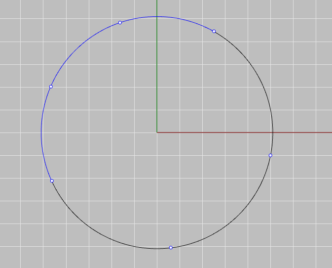

Hey everyone,
I have a small question, but I can’t get the solution.
I want to only delete the points on the blue curve with python code.
I have already got these points with x/y/z coordinate.
with rs.DeleteObjects() to delete the objects need the GUID of the point.
But how can I get the GUID of an existing Point?
Here is my code and the GH,Rhino document.

could someone give some advice?
rhinoscriptsyntax:
crv = rs.GetCurveObject("Select curve to delete points")[0]
for obj in rs.AllObjects():
    if rs.IsPoint(obj):
        t = rs.CurveClosestPoint(crv, obj)
        cp = rs.EvaluateCurve(crv, t)
        if rs.Distance(obj, cp) < rs.UnitAbsoluteTolerance():
            rs.DeleteObject(obj)
DeletePointsOnCurveRhinoscriptsyntax.py (327 Bytes)

Thanks for both two answers, Mahdiyar!
but the first with rhinoscriptsyntax didn’t work, it will clear all the points including the points in the black lines.
Sorry, I’d forgotten rs.UnitAbsoluteTolerance parenthesis.
I have already try to put a 0.001 as the absolute tolerance number in der rs.UnitAbsoluteTolerance(), but it didn’t work. Could you give me a little explanation?
Thanks you so much! I have found a solution!
