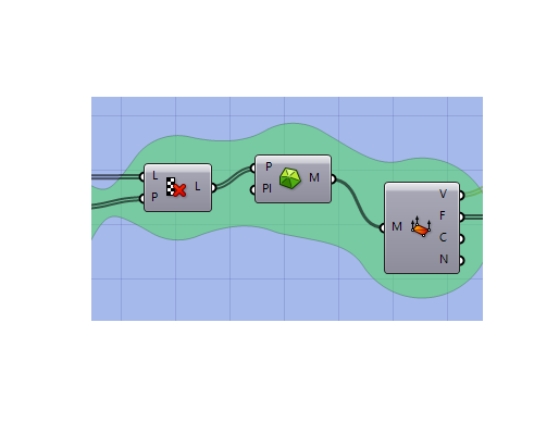

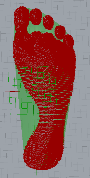

I am trying to make a kind of insole for the foot, and when I start from a set of stitches and I want to make it mesh or brep, the silhouette is deformed. Is there any form to reach this without delaunay mesh??

The delaunay mesh basicall creates a convex hull…
Have you tried Shrinkwrap?
It works more or less fine, and how can I join 2 meshes if I want to fill the space between them, as if to give thickness taking into account that the meshes are not identical.
