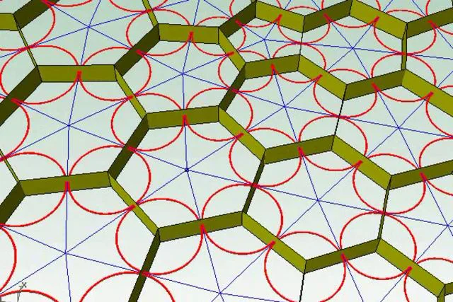

Ok and how about a mesh quite “close” to my surface with curves than I can project to?
Kangaroo has some good mesh rationalization examples floating around (along with mesh machine), but again more than likely the faces wont all be exactly the same, another option is to make all same faces and make up the difference with different gap sizes between panels. The museum example uses a mix of clusters of same panels and varied gap sizes.

do you know how I could get rid of that curve or point
Yes, by not using the methods you are using, Lunchbox stuff follows nurbs surface UV’s. I would use kangaroo 2 and circle pack on the surface and construct panels from those circles (like they did on the museum I sent you)
See here the circle packing on surface example file: Kangaroo2 additional examples - Grasshopper
