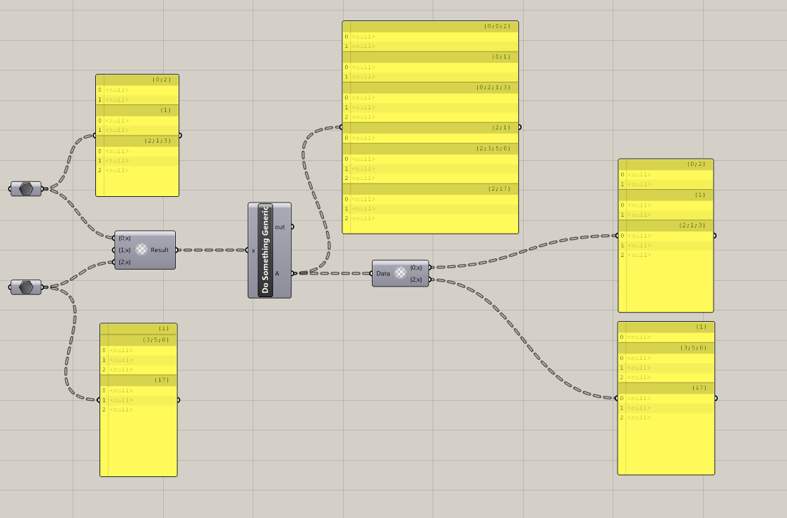

I was wondering if there is some way to create a reverse “Entwine” function with native Grasshopper components. Context would be to take various DataTrees and merge them to one stream while conserving the tree structure, apply a common operation to them, then split the trees back in the original tree structure (and just reverse the effect of entwine).
Until now I have just written a custom component mimicing the behaviour of “explode tree” while conserving the “original” tree structure.
Is ‘Unflatten’ what you are looking for?
I think the idea would be to merge data streams and to split them apart again… Similar to Entwine/Explode but while maintaining the existing tree structure of the streams.
As long as your operation operates on single items at a time (i.e. no list inputs) this works:
effectively, you temporarily discard the tree structure by entwining in “flatten” mode and then use unflatten to reconstitute each individual stream’s structure. Not the most elegant, and doesn’t work in every case, but it does work.
I also often tackle cases like this with Metahopper’s Wrap and Unwrap components:

Thanks, that looks promising :wink:
The random trees were just to test a rather general case and probably not a realistic scenario.
