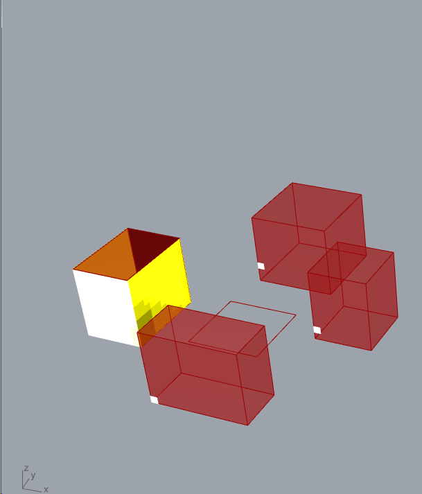

I am running into issues wrangling data somewhere in the facade grid or panel creation portion of the Cyclops sunlight hours tutorial when using a collection of breps. The same issue appears if I mesh the breps in rhino. What do I need to add/change to get the coloured mesh faces to retain their positions?
It would be very helpful to have a tutorial that shows this sort of data flow in subsequent Cyclops releases. Many thanks,
cyclops context analysis.gh (27.2 KB)
Hi @Maxim_Frampton , this looks like a data mismatch. You can quickly fix it, by directly extracting the mesh faces :slight_smile:
cyclops-context-analysis-fix .gh (20.8 KB)
Brilliant! Mesh Explode is quite a handy component. Thanks for the speedy reply
No probs, feel free to reach out in case you face any other issues. Also, please mark above answer as resolved to close topic! :slight_smile:
