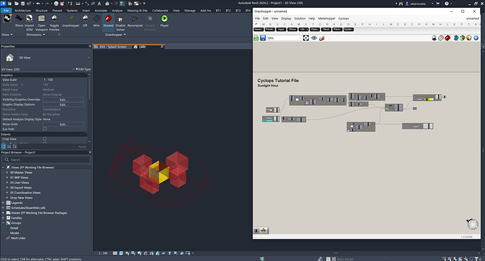

I’ve just tested Revit 24’ & Rhino 8 and it seems to work as expected.
That said, Revit 2025 might introduce some issues due to the upgrade to .NET 8. It’s not a top priority for now, but it’s definitely something we can look into in the future.

Thanks for that! Does it work with Revit 23?
It seems to be working on my end (Revit 2023 & Rhino 8), but things can still go wrong—usually due to dependency conflicts with other plugins or how Revit loads them.
