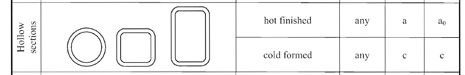

I´ve been checking the alphas that your code sets. I´m sorry, but I think they are not right. (but I´m not an expert in Eurocode :slight_smile: )
Please, correct me if I´m wrong, but according to EN-1993.1.1:2005 (EC3), a cold formed CHS (EN10210-2) (Product = 0 “cold formed”) should use buckling curve “c” (i.e. alphaY = alphaZ = 0.49). However, your code sets alphaYZ values to 0.34 instead.
SetCrossSectionProductType3.gh (29.3 KB)
For hot finished (Product = 1), the curve “a” (alphaYZ = 0.21 and alphaLT = 0.76) seem correct.
(page 57 EC3)
In Table 6.2 “Selection of buckling curve for a cross-section” (page 58 EC3)
Please, would you check if I´m wrong? Thanks!!

Hi @Vigardo,
thanks for the bug report regarding the alpha values for CHS according to EN10210-2. I will change that.
