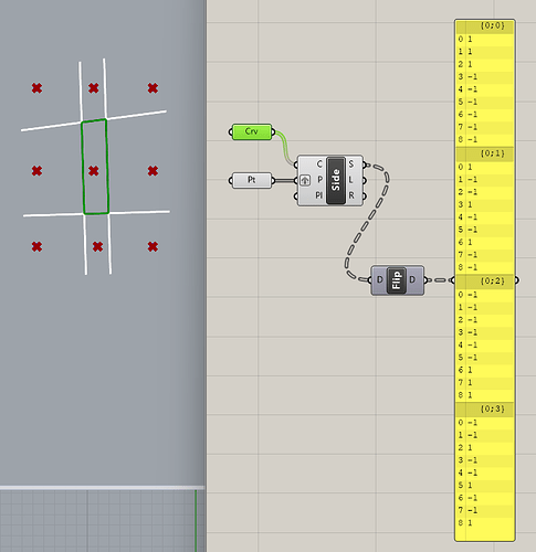

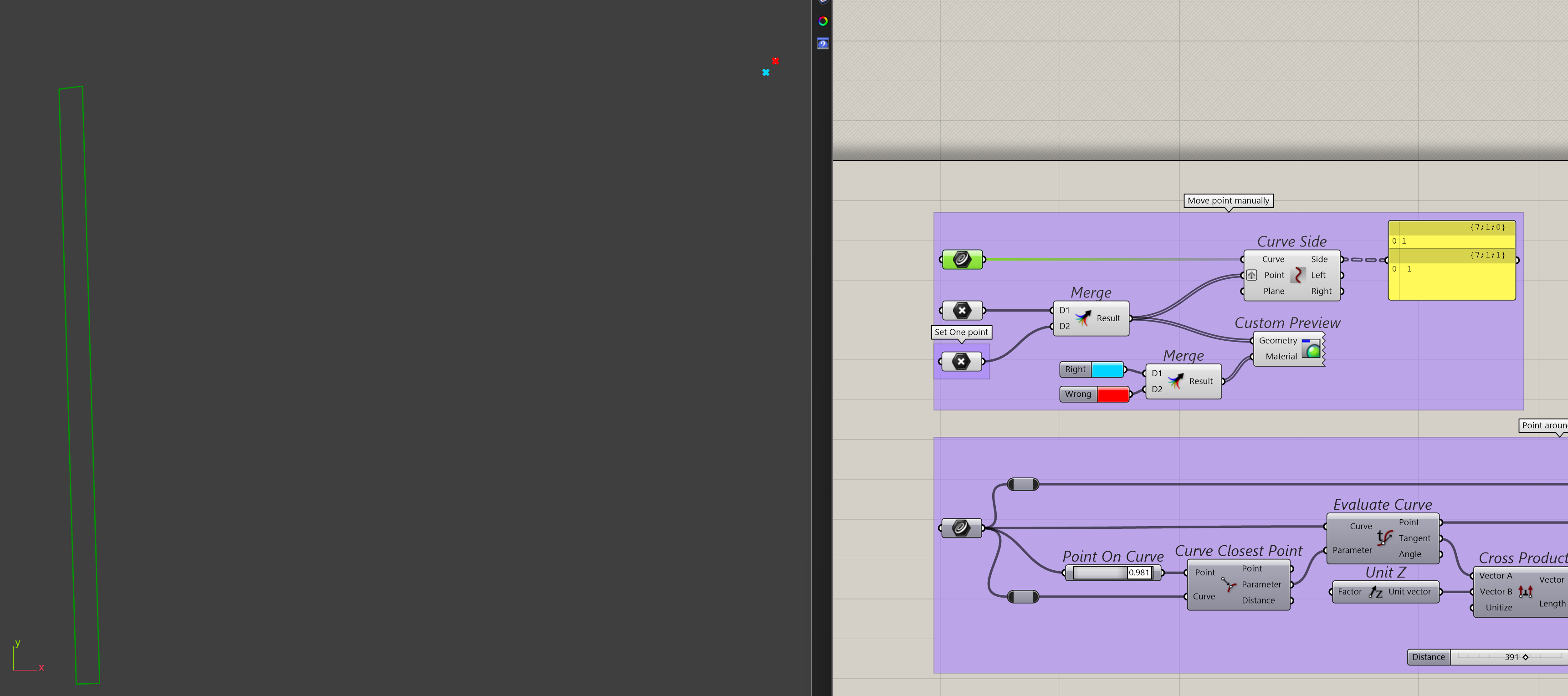

I’m using the Curve Side component to test whether a point is inside or outside the curve as takes roughty half the computation time of the Point in Curve component. Since all input curves are closed and flipped in the same direction, any point outside the curve should always be to the right of the curve. This holds true for the most part, but there’s apparently a malfunctioning zone in which the Curve Side component outputs a -1 meaning left instead of 1 meaning right.
Below you can see that a small change in the point’s position leads to the output flipping:
And with a video demonstration:
Curve side malfuctioning zone.gh (30.0 KB)

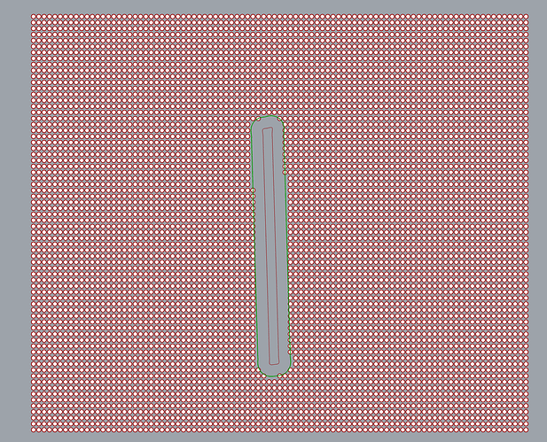

All these points should be on the right side of the curve.
The seam of the closed curve is there:

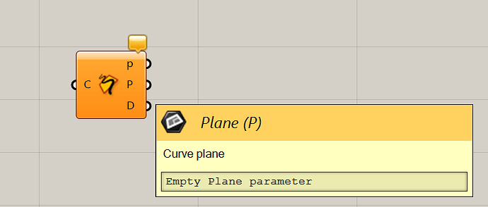

You could have used this component to extract the curve plane…

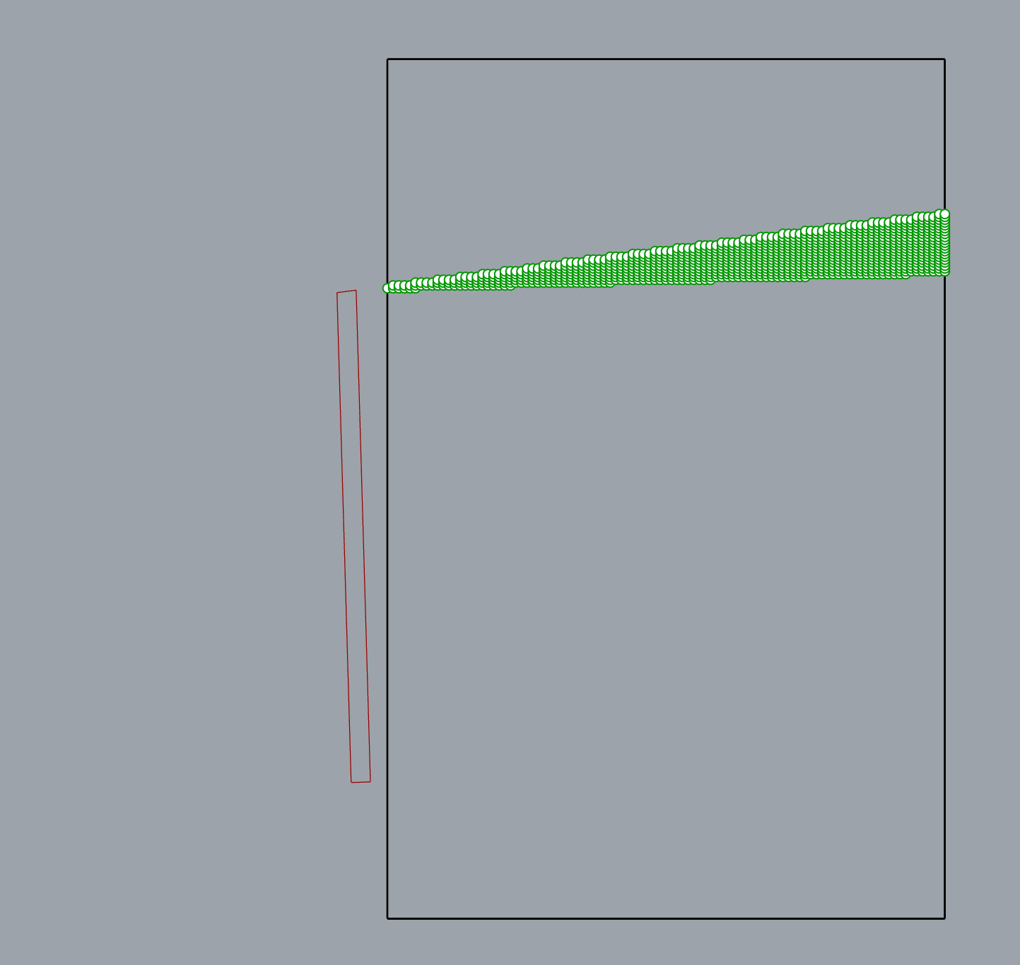

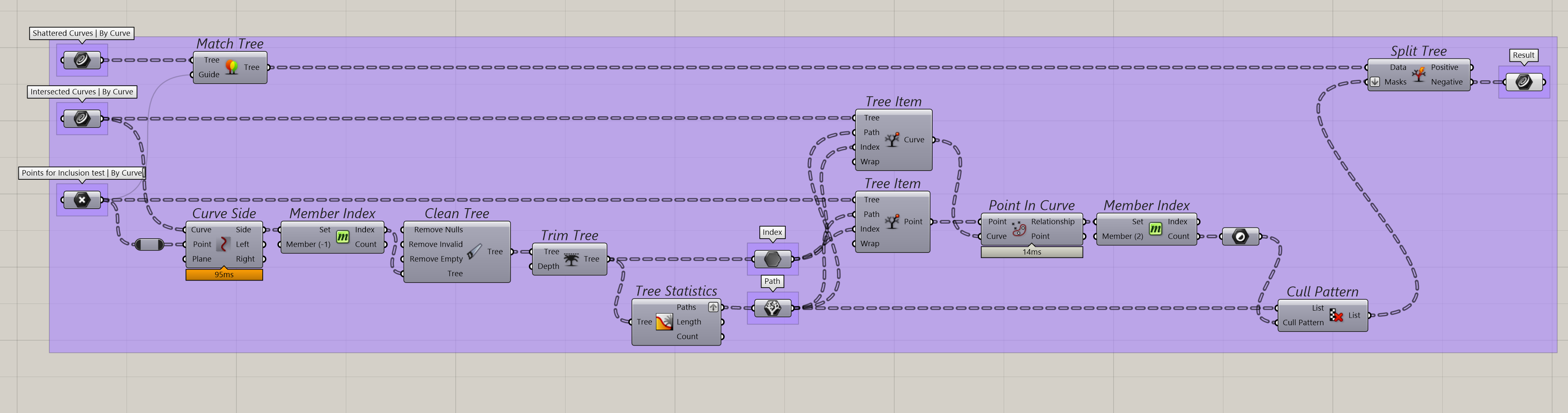

I was suspecting that that might be the case, but thought it was odd, considering the deadzone is quite large. Well, here’s one fail-safe test, which is to retest the -1 points with Point in Curve, which ends up being faster still with the Curve Side preprocessing:
Curve side malfuctioning zone_solution.gh (538.9 KB)
E: Surprisingly, it is already faster that identifying the point that is closest to the seam (which the True value indicates):

I think there is a misunderstanding here. There is no malfunctioning zone. The side is simply being expressed in relation to the first segment of the curve only. If you move the seam point you get a different outcome because you are changing the first segment.
Left and right are not the same as inside and outside. I suspect that the first segment only is used because side varies by segment and it becomes meaningless to state a side when it is both left and right as it would be if all the segments were used.
If you divide space into nine sectors by extending the four line segments then all points within a sector will have the same set of left/right values for each of the four segments:
Note that points lying within tolerance on a sector boundary can ad hoc return left or right (it would make more sense to return ‘neither’ consistently).
