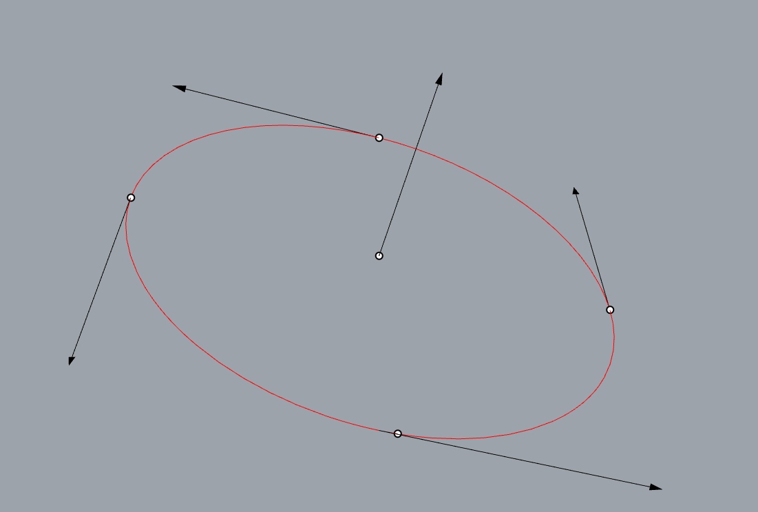

I have the same curve in Rhino5 and Rhino6.
In Rhino5 I get correct result (if compared to what I see also in Rhino when performing Analyze Direction),
in Rhino6 i get the opposite (and apparently wrong) result.
Is that a bug in Rhino6? Something changed?

The first one is on Rhino 5, the second one is on Rhino 6.
When viewing the curves (each on the respective Rhino version) , and select Analyze -> Direction, I see the same direction (clockwise when looking towards the same direction of the Y axis), on both Rhino5 and Rhino6.
But, calling the function Curve.ClosedCurveOrientation(…) (using a vector parallel to the Y axis, or a plane with the normal parallel to the Y axis), I get opposite responses
Rhino5 --> clockwise (expected)
Rhino6 --> counterclockwise (wrong?)
(using Rhinocommon library on C#)

Hi @donato1,
Your curves are counter-clockwise with respect to the world y-axis (0, 1, 0).
The Rhino 5 calculation is incorrect.
https://mcneel.myjetbrains.com/youtrack/issue/RH-32952
– Dale

Hi @donato1,
No, it’s not sufficient to just flip the results.
In Rhino 5, you will want to use the Curve.ClosedCurveOrientation override that accepts a Transform as a parameter.
For example:
import Rhino.Geometry as geo
curve_id = rs.GetObject("Select curve", rs.filter.curve)
curve = rs.coercecurve(curve_id)
# The target plane to test against
origin = geo.Point3d.Origin
xaxis = geo.Vector3d.XAxis
yaxis = geo.Vector3d.ZAxis
plane = geo.Plane(origin, xaxis, yaxis)
# Transformation to map the curve to the world xy plane
xform = geo.Transform.PlaneToPlane(plane, geo.Plane.WorldXY)
# Do curve calculation
print curve.ClosedCurveOrientation(xform)
– Dale
