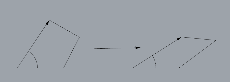

Hi Randy. Thanks for your efforts.
I’ve attached an image to more clearly illustrate what I was after. The lines need to remain constant lengths, so as one angle changes it causes the opposite angle to adjust (and the adjacent angles to adjust in the opposite direction).
In essence, I am after a grasshopper function which calculates the location of a point given its distance from two reference points.
Well one way to do this is to use the intersection of two circles whose radii represent the lengths of your secondary lines, and whose centers are the ends of your primary lines. Attached is a quickie GH definition - done in GH for Windows Rhino but should work on Mac - to give you an idea. The complication is that the circles could intersect in two points, one point or none at all (meaning no valid solution) - depending on the angles and lengths of your initial lines and your secondary ones. The solution here simply takes the point furthest away from the origin of the first two lines. I left the circles visible to see what’s happening.

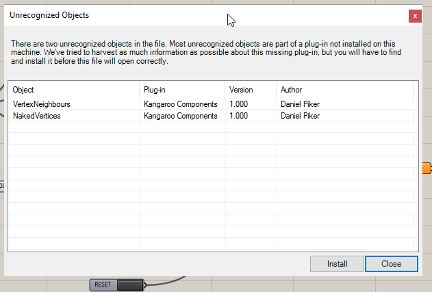

Hi daniel,

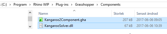

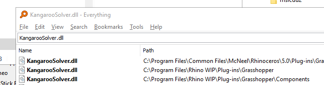

I just updated the Kangaroo plugin and then I found that I have three (3) Solver dll’s. Two in WIP. Isn’t this one too many in the WIP folders, and if so, which one to drop?
// Rolf
Hi Rolf,
Kangaroo(both the dll and gha) should be installed in the folder you get to from the Grasshopper menu >File>Special Folders>Components Folder.
This should be something like C:\Users\Daniel\AppData\Roaming\Grasshopper\Libraries
You can delete all the other copies of those files you have.

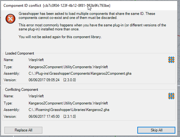

If I do so, and keep the WIP files (Kangaroo2Component.gha and KangarooSolver.dll) I get a conflict message each time I start WIP.

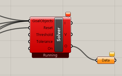

If I delete those WIP files, then when I open your (git) example files in WIP, like Catenary.gh for example, I get a message that component is missing (I think it is the latest Solver from 2.3.1 that is missing)
The Solver goes red and dead:
// Rolf
I tried to restore WIP’s Kangaroo2Component.gha and KnagarooSolver.dll but it seem I cannot run the Catenary.gh examples on any version of Rhino. I installed the last 2.3.1 version on Rhino5, but I don’t know how to do the same in WIP as to make it work.
So now I wonder if the problem is in the Catenary.gh example or in my configuration(s)? No combination seems to work)
// Rolf
Hi Rolf,
Thank you for your patience sticking with this!
The gha and dll to use are the ones from Food4Rhino - 2.3.1 is more recent than the one included in the WIP.
So the files should be called just Kangaroo2.gha and KangarooSolver.dll, and when you hover over the dll in file explorer it should show version 2.3.1.0
However it seems there is also another issue - I appear to have still left some Kangaroo1 components in some examples, sorry. I’ve just committed a fix to the Catenary.gh example, but am going to go through the others systematically now to make sure.
That’s OK. I have now cleaned it all up and installed only 2.3.1 in the Components folder and I’ll await your update of the examples, no problem.
// Rolf
