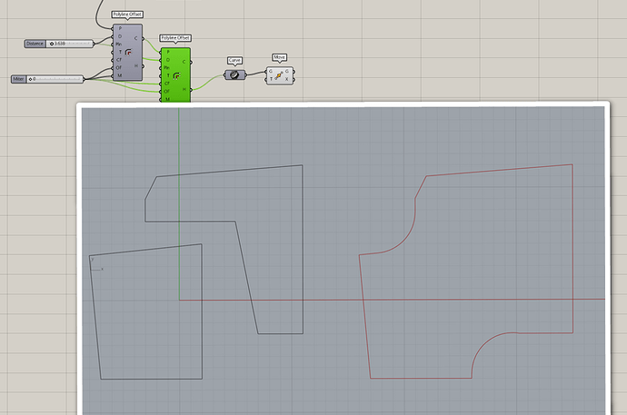

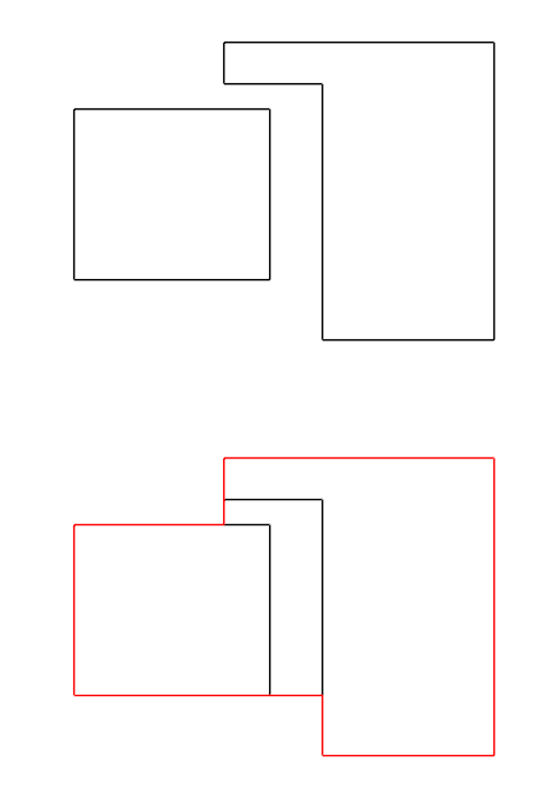

I have two separate breps but I need to create a common boundary line touching two breps. I have attached an image of top view of brep where in top there are two separate breps on the bottom you can see boundary line (red line) highlighted in red colour. May I know how to achieve that without manual methods in rhino and can be achieved using grasshopper? please help
Hi
here is the definition dealing with 2 closed curves, tested in varius orientations.

Just to complement clever definition by @Jakinta, you can use Clipper to offset 2 times. This gives more possibilities.
curve test boundary.gh (2.3 KB)

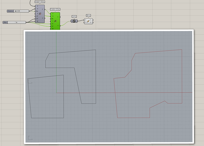

Thank you for the definition. But it didnt work for all curves. I attached a curve below kindly have a look.

Thank you for the definition. But it is far from what I like to achieve
May I know what component is “polyline offset”? I could not find it in my gh
Thank you very much but what if there are multiple curves ? I have to repeat the definitions? Kindly find the attached curves

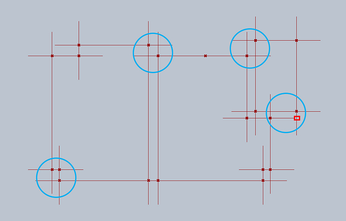

In case 1) extension approach as @ [Seghier khaled] would be the best. The question is how to chose proper extension distance so it dont mess all possible cases, like…
In case 2) @ Laurent Delrieu Clipper based solution suits well.
In case 3) preproccessing the curves by grouping them on proximity is neccessary…
By my humble opinion, when the curves are grouped properly, general solution is to find the closest control points ( similiar as in my definition), extend the proper segments by measured distance + small number so it intercests the polyline and then do some “region bounding”.
How to choose proper segment to extend because there are 2 on every control or disontinuity point?
Test which one has larger angle on closest polyline…for example
Maybe this work for different cases but sometimes you need to adjust the sliders (polygon radius & addition)
bound2.gh (22.3 KB)
This is some incredible work. You are the real mvp today. Thank you very much for your brain for the work and create something neat and impressive like this. bows head down
