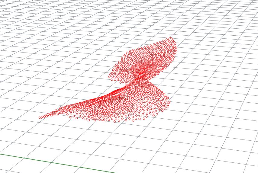

Hi Daniel,
Actually i have coordinates in excel for different models.
from there i am plotting in rhino & sharing.
But for the curved location script is not working can you please check.
Point to Mesh Model2.3dm (647.8 KB)
Hi Daniel,
Yes, the approach I shared above was for shapes like your first one that can be projected onto a sphere without overlapping, so it won’t be suitable for all shapes.
The ball pivoting approach that HS_Kim linked should work with more general shapes.
