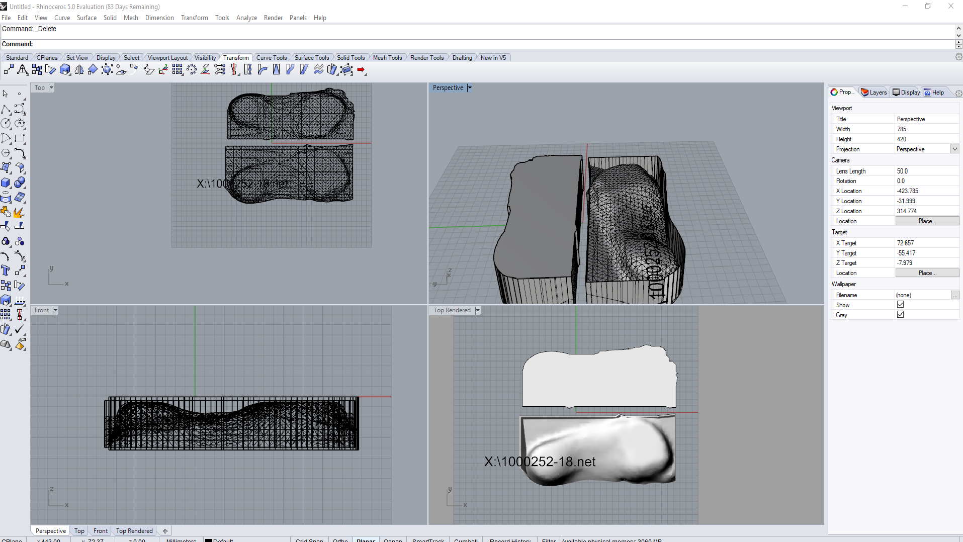

Do I understand your problem correct? You want to mill the last without using Rhinocam?
If that is the case, You have to slice the last in several layers and you have to make a outline of each layer. additional you have to make a outside offset of half the mill diameter and that will be the line to follow with the mill.
I made this example of my hand in foam, scand it, sliced (mesh Split) it in very thin layers, did this every 5mm in height, mesh outlined each layer. (To show it, I added a color to each mesh) Additional you had to add the offset line.
