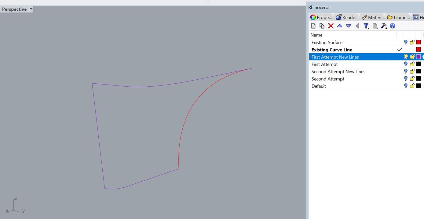

Hi Rhino Pros,
I am trying to create a new surface that flows from an existing surface to a new intersecting surface from a series of fixed lines. This new surface needs to retain as much of the existing surface geometry as possible.
So far, I have tried 2 ways but I am not happy with the result.
Attempt 1. I tried to create a “curve network” surface between an existing curve on the existing surface and new fixed lines. The problem is that the surface bulges out too much and does not retain enough of the tight curve in the existing surface. Refer to images below.
Attempt 2. I tried to trim the existing surface back to where the X axis lines start to curve. I then ran the “curve network” tool between the trimmed surface and new lines. However, the new surface curves out rather than follow the straightness of the existing surface. Refer to contour image bellow.
How do I create an adjoining surface that retains as much of the existing surface geometry but flows continuously and nicely along the new curves without bumps?
I’ve attached sequenced photos and the 3dm to help you understand my issue.
I would be very grateful for anyone’s help! I will donate $10 to charity if you can help me so I can repeat the technique across the rest of my model.
Surface Intersection Question.3dm (1.8 MB)

Hi Sweezy - I’d keep the whole thing way simpler, as in the attached file - is that on the right track?
[Surface Intersection Question_Maybe.3dm|attachment]
Surface Intersection Question_Maybe.3dm (927.8 KB)
Hi Pascal,
This surface is really beautiful and what I am after.
How did you do it?
I am keen to replicate it on the rest of my model.
If there’s a particular charitable cause you support please let me know in the reply.
Sweezy.
Hi Sweezy - It looks like I started from your ‘Second attempt’
  1. The existing surface is way over defined - I duplicated the edges and rebuilt these to degree 5 and 6 points. The deviation from the original was small enough, I decided to go with the cleaner curves - 7 mm in 10,000 mm…
  2. Loft the two curves to get a clean simple surface.
  3. I connected the ends of the two transition curves with a new curve, in this case using ShortPath but looking at your other attempts it looks like you could use the edge curve of the loft or an extracted isocurve, depending on where the new surface should hit.
4.Loft the curve to the vertical line:
  1. MatchSrf to the original surface at the curve you are using to define the end of the new surface. Use ‘CurveNearSurface’ = On in matchSrf. Match for Curvature, and leave the ‘Other end’ at Position. ‘Match target isocurve direction’. Watch for the ‘Flip’ and click the Flip button if it decides to match the wrong way.
