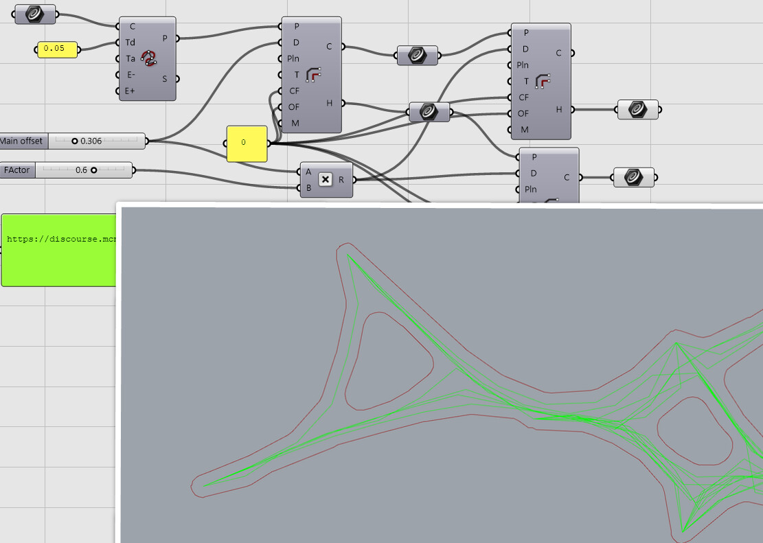

this technique also works in 3d with Dendro. The only problem I know is that it could become jagged because Clipper and also Dendro work with finite elements (pixel and voxel)
hey Jack, first of all maybe off topic ._______. how do you make the green network line? I was wondering, I want to know the way you do it. I’m having trouble creating a similar network curve. Many thanks(:
Search with “Edge bundling”
many thanks laurent:'D
Hi Baharmustafa009, sorry for my late replay … haven’t visit the forum for a long time…
I made the network lines based on Daniel Picker’s Wool thread definition:
