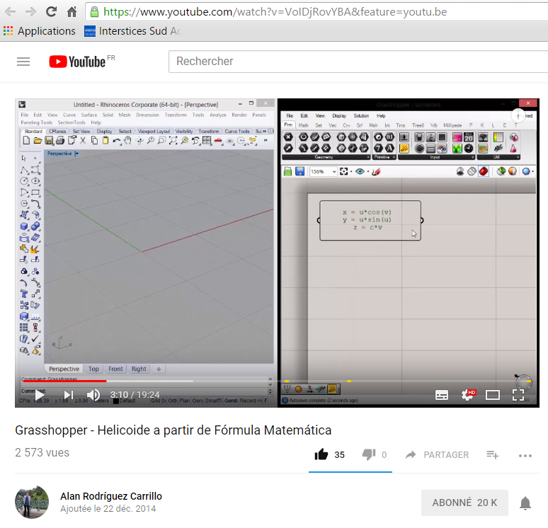

I’d like to know step by step where, and how i can write this on grasshopper, please?
It’s a tutorial on youtube, the link is:
https://www.youtube.com/watch?v=VoIDjRovYBA&feature=youtu.be
Thanks so much! :smiley::smiley::smiley:

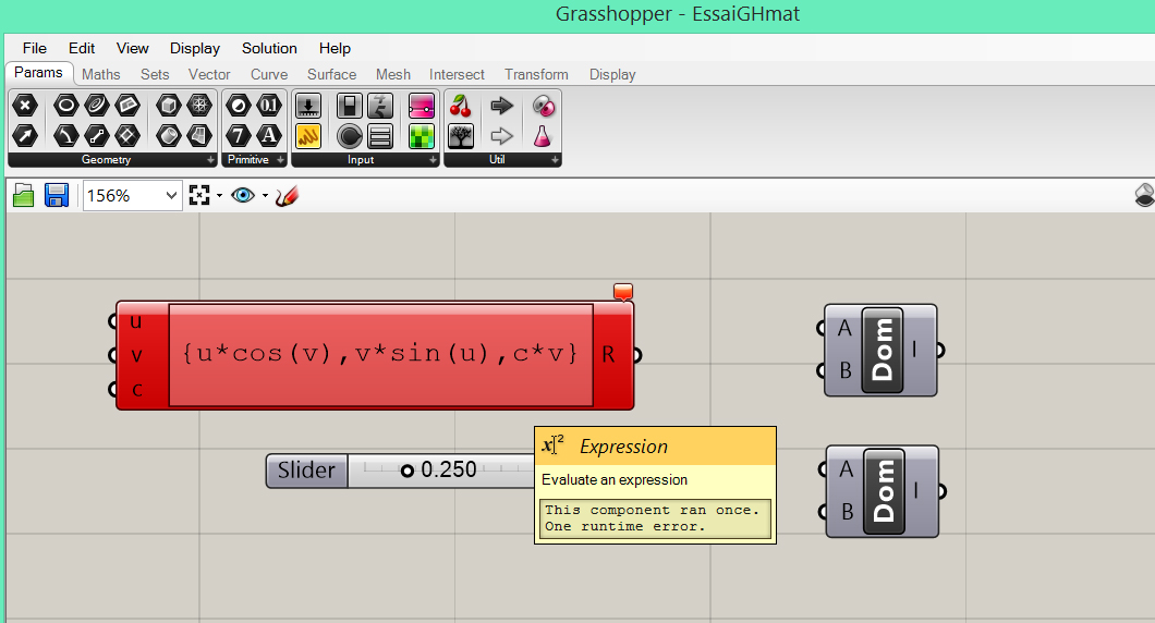

Hi David! Thanks so much! Sorry… i’m beginning from zero!
Is it ok what i have done, showing here my screenshots?
Here i’m at 4min56 of the video tutorial, the thing is maybe i did a mistake, because the pannel i created is in red, and so, i think it’s showing a problem, no?
Thanks so much!:grinning::grinning:!
I don’t see any wires connected to the Expression inputs? Click the little box at the upper right corner of the red component to read the error message.
As @Joseph_Oster said, you haven’t put any numbers into the u, v, and c inputs, and Cos, Sin and * aren’t defined for null values.

Now, it’s ok!

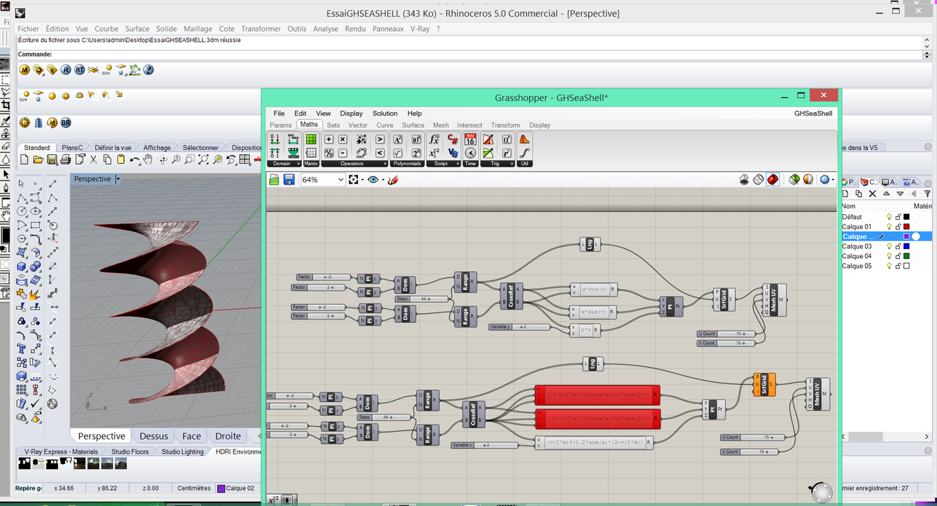

As you can see on the picture here!
Only that the line on the bottow is a try i do, in order to create a shell, frm the formula. As you see, i think i made a mistake, it doesn’t work, i don’t know why!
I would like to create two other surfaces from mathematic formulas: shell and elliptic hyperbole. For this, now, i will create two new topics on the forum. As i put on my screenshot, i think i made mistakes, because it doesn’t work! Thanks so much!:grinning::grinning::grinning:
Post file… Btw you opened 3 threds on nearly the same question.
