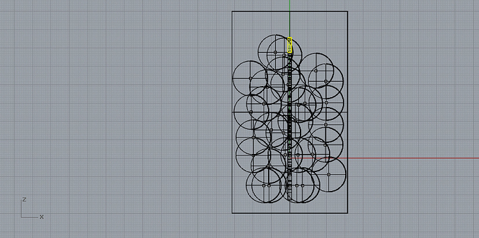

I am trying to connect a cluster of spheres with a wall surrounding it. However, only the closest spheres are to be connected at the following criterion:
gap = cylinder wall radius - sphere radius - rs.Distance(point1, point2);
tolerance = 0.080
val = gap/radius
Since there is no easy way to connect them solely on sphere particle and wall coordinates and dimensions, I decide to make an orientation from center points of cross-sectional area of the cylinder wall, as the bridge is perpendicular to the wall (z-axis).
Therefore, gap could be determined as
gap = radiuswall – radiusparticle – rs.Distance([0,0,zi] – point1)
To make the geometry, I wrote coding as follows:

for i in range(len(points)):
    rs.AddPoint(points[i], radius)
    rs.AddSphere(points[i], radius)

for j in range(len(points)):
    rs.AddPoint(points[j], 31.5)
#forming wall-particle connections
        if (isConnected(points[i], points[j])):
            direction_vector = rs.VectorCreate(points[i], points[j])
            cylinder_plane = rs.PlaneFromNormal(points[i],direction_vector)
            rs.AddCylinder(cylinder_plane, 8, 1, cap=True)

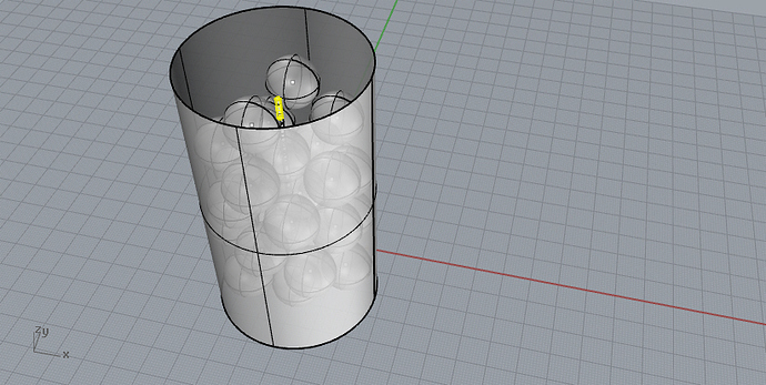

#cylinder wall
cylinder = rs.AddCylinder([0,0,-30], 110, 31.5, False)
As seen, I try to split the cross sectional wall center and sphere center points as ‘point i’ and ‘point j’, respectively. However, the geometry isn’t the one I expect.
Despite orienting the direction vector radially (from center outward, see Line 95) and making ‘points i’ as cylinder bridge bases, the bridges are based on ‘points j’ and pointing upward/axially. I suppose I did something wrong with labelling of points i and j but I am still new in Rhino-Python.
I set the bridge length longer than total distance of gap and sphere radius (see line 99), but it is not a problem since I can do Boolean difference later on to tidy it up.
Could somebody point out what’s wrong with my code and suggest what I should do with it? Thanks in advance.
