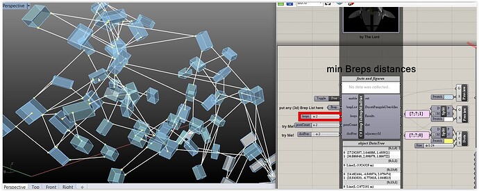

This is an iterative procedure to find the closest point on both BReps. First you start with a point on one BRep A, then from that find the closest point on BRep B. Then using the closest point from B, find the closest point on A, etc. etc. until there are no more changes.

Try to get the gist of the logic (that’s C#) and then … try to write something similar in P.
Explanation: this works with Lists (of any Topology - shown boxes for clarity).
  1. Get a pair of Breps (say b1, b2) that are not taken (using a bool [ breps.Count , breps.Count ]).
  2. Define a rnd pt in b1.
  3. Find the closest pt in b2.
  4. Define one from the other and the other from the one. See Loop with 2 lines: pt1 from pt2 and then pt2 from pt1.
  5. In real-life one needs 4-6 iterations (contolled by the loops val).
Tip: as an option [case: “heavily” concave Topologies - you can inquire these via various ways] you can apply 2 passes: first approximate using solely Boxes and then refine using Breps (or Meshes or cats or dogs or whatever).
Tip: as a PlanB you can define pts on b1, b2 Faces (i.e. not inside) and find the closest pair (via a classic divide and conquer approach and the likes).
