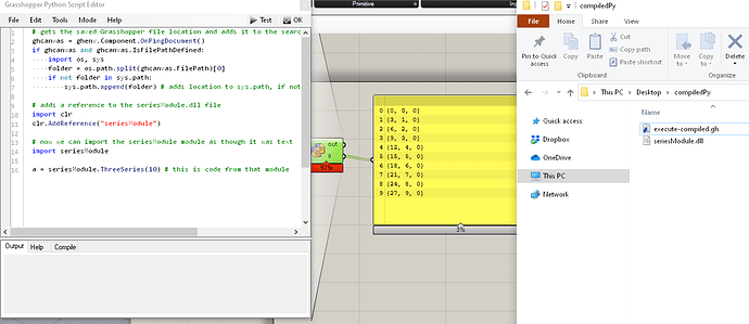

Here is what I did:
  • downloaded the ZIP file attached to the first topic item
  • unblocked the file
  • extracted all contents to a directory
  • opened execute-compiled.gh
I see this:
I don’t see errors. Is this the same as what you do?
Please note that this does not load the .py file at all. The code is loaded from the .dll.
For example,
Does it help?

Do you have an Independent IronPython installation?
Yes I do. An older one than what Rhino 6 is shipped with. I have 2.7.3rc1.
Is that the cause of the problem? Rhino’s ironpython is sufficient?
Could well be, because GAC assemblies get priority. I’d try uninstalling that.
Thank you Giulio!
That worked perfectly! I should have payed more attention to your article.
