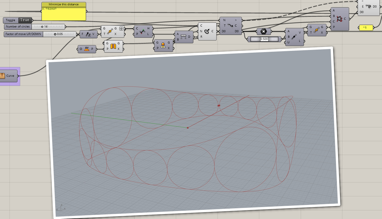

Here is a solution, not fully automatic but it helps. You will have to obtain the convergence by end.
It uses Circle Tan Tan Tan and Anemone
You have to specify a number of circles (indeed Number of Circle -2).
Then you move the up or down the curve in order to minimize the distance betwen the first ans last circle.
With 16 circles (slider at 14) you have to move up the curve 0.05 unit.
With 33 circles you have to move down the curve -3.42 unit.
catedralforum2_LD.gh (24.9 KB)
A version with some automation
First iterate with differents heigths then find the minimum and apply it.
catedralforum3_LD.gh (39.1 KB)

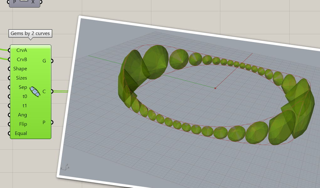

It is also possible to use Gem By 2 curves from Peacock
It was hard to resist to go to a solid model

Hey man I’ve been playing with peacock, It works like charm,
I’m wondering, is anemone your go-to plugin when doing recursive calculations? I see that peacock is a bit limited in the output it can generate and is ( for some reason I don’t understand ) specialiced in jewelry geometry
Anemone is the best for that if you don’t want to code. For my projects I often prefer c#.
Peacock is developed by a jeweler Daniel Abalde @Dani_Abalde
