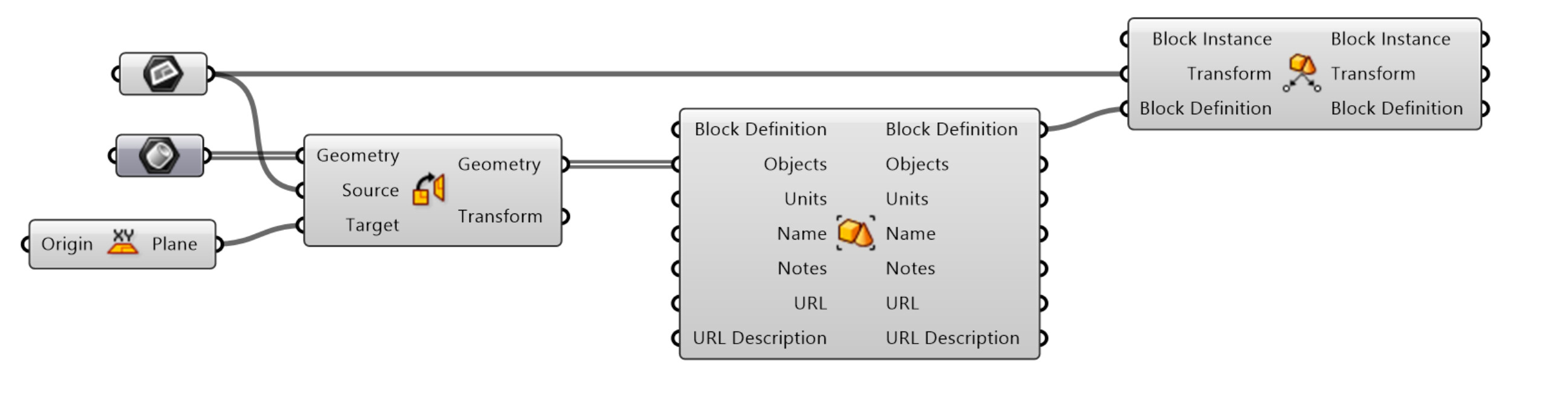

These three components create the new rotation plane:
  1. Grab the transform (includes insertion point and its current rotation)
  2. Turn that into a plane,
  3. Then send that into a XZ plane that will create a new plane vertical thru the blocks insertion plane so we can rotate on that axis.

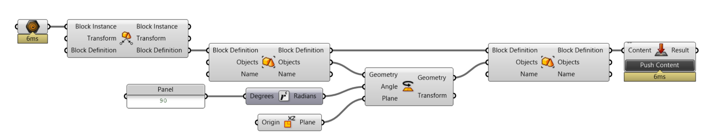

This is how it looks when dealing at the Block definition level. Block definitions are always at 0,0,0 origin point.
In this case the objects within the definition are all rotated individually, then redefine the block itself.
Thanks for the illustration. I was able to figure that portion out. I think geometry nodes just isn’t the right solution for this since it’s just making a single change to some element in the scene. There’s no reason to make that parametric really. I don’t know how to actually “bake” that kind of thing with grasshopper. I did the rotation. now what? Plus, I need to actually rotate the block itself, not just the instance.
