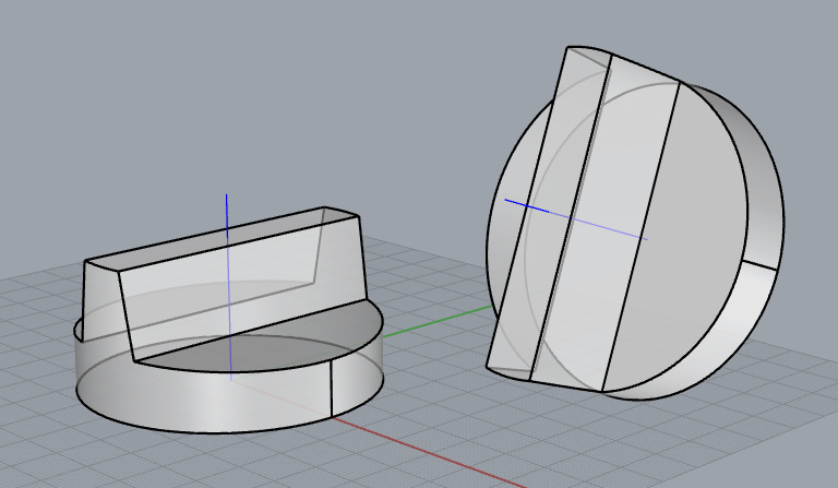

If I’ve got an object that’s already at an angle, but then I want it to be a block, the block base isn’t quite right. So I have to rotate the object first, create the block, then rotate it back.
Is there any workaround for this? It seems it’s using world Z as the direction.
I tried changing the Cplane prior to defining the block, but it didn’t change anything.
I’d Love to be able to select the block base, then choose another point for the Z direction.

I think he means that he wants to define a Block out of a “tilted” object as if it was aligned with World, but orienting a CPlane to the object instead (mimicking World).
In this way he would not have to rotate the object to World before making a Block our of it.

Yes, In this file, The knob centered on the floor would be fine. The knob created in place at an angle has only world space coordinates. I created a line through the center, in blue, that should be the object’s Z direction as a part.
If I have the object in place, in order to create a block with the proper direction, I have to rotate the object so that the orientation of the object is world up. It would be much faster to simply specify a second point after the base location.
Does that make it more clear?

So, you’d like to define a block from the object in its current location and orientation but have the actual underlying definition in world space and the relevant transform applied to the new instance that you ‘create’ so that the instance does not move… Right? That is probably possible in a script… I’ll have a look if I get a chance.
That is exactly it Pascal.
Currently, I create a line through the center, then create another line perpendicular to world. I then rotate my object from it’s current orientation to the world orientation. There, I define the block. Then I rotate the item back to the intended angle for rendering.

Hello - here’s a crude start - see if it does anything good and we can clean up the UI.
Probably the best way to test is to set a CPlane on the blue line and at the prompt in the script for three points, use the plane origin, X and Y axes - we can make this better, I just want to see if I am getting the basic process correct.
Hm - never mind - not quite there yet…
@kalamazandy - ok, I think this will work…
BlockWorld.py (1.2 KB)
I could just make it always use the current CPlane and not ask any questions, that is probably better. Changed, above - Insertion point is the current CPlane origin - up to you to set the plane ahead of time…

So after my morning break hiccup, yes, the script works fine.
I tested the angle and it worked as I expected.
I did _Cplane _Surface, selected the surface of my cylinder, and chose to place it at the center.
Then I ran the script, and voila.
