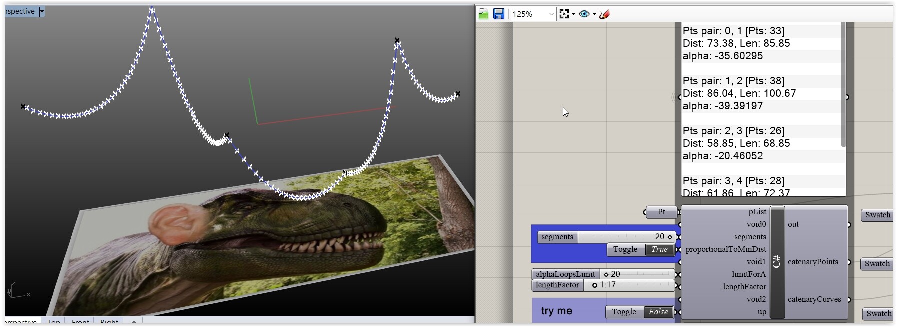

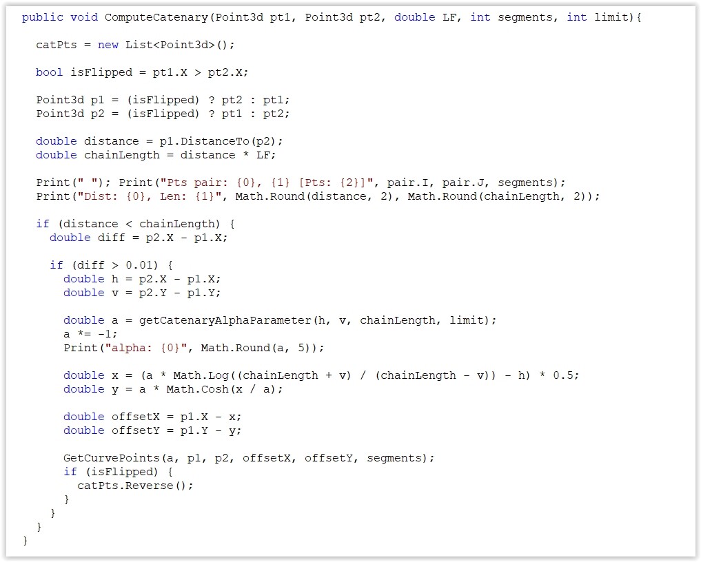

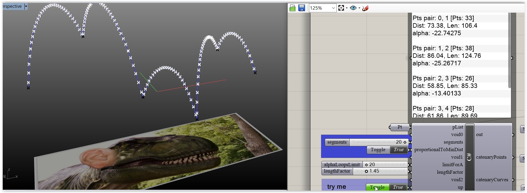

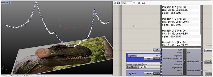

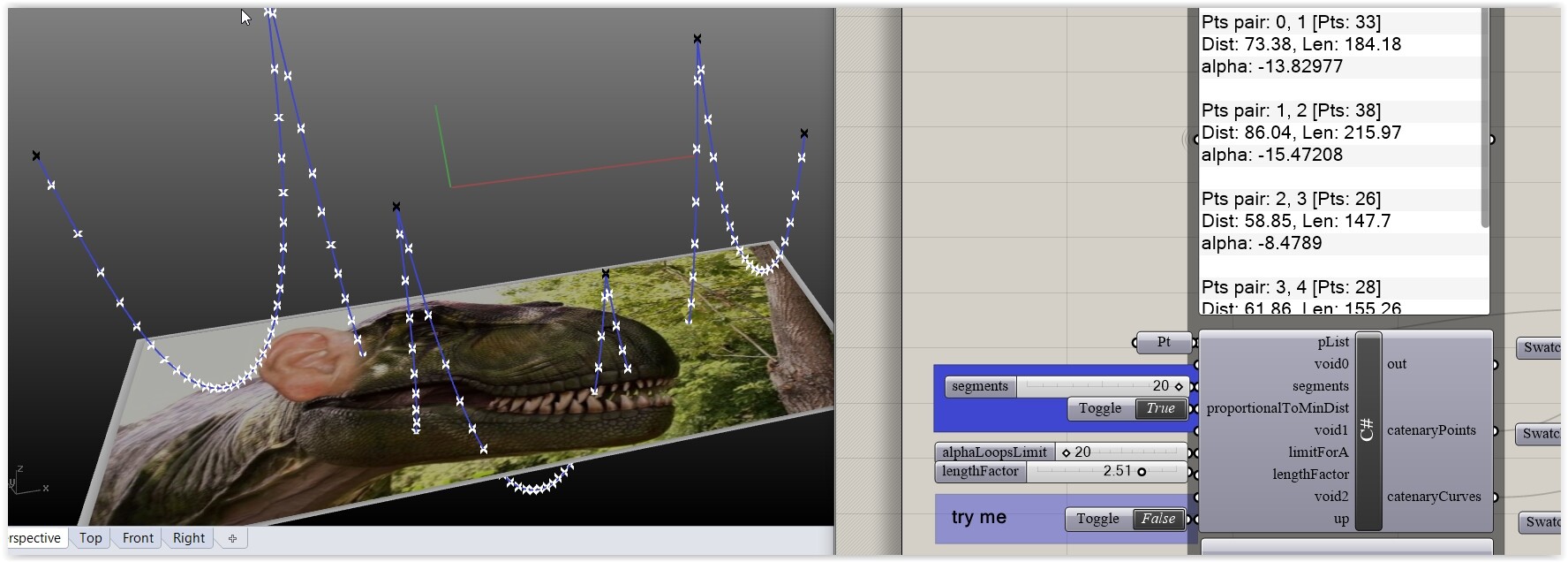

Try PlanB as well: a “direct” way to cut the mustard:
