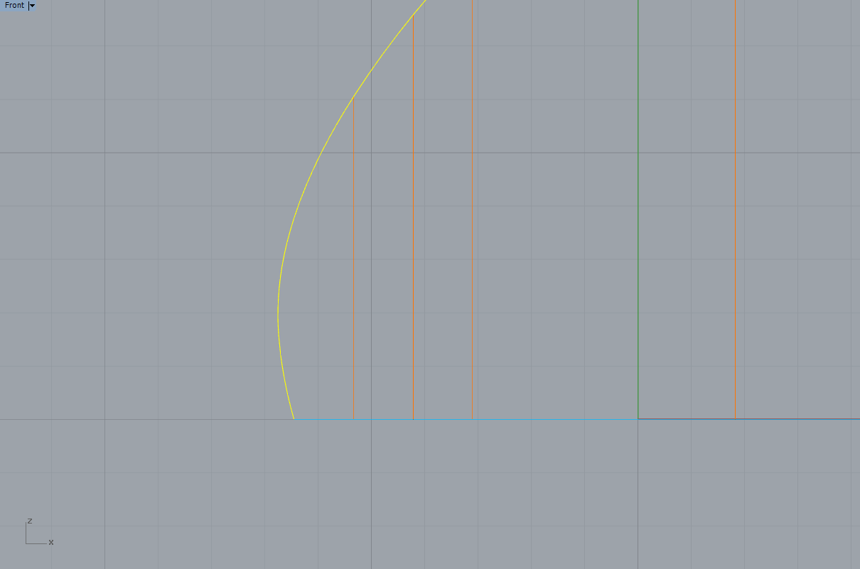

Hi Lujohe- rearrange your curves like this:
Then NetworkSrf will get you something.

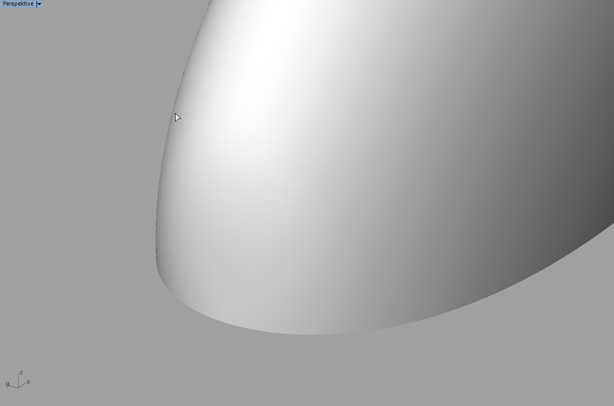

Just one thing: Is there a quick way to get rid of the bumpiness?
Have a great evening
L
i am not sure but maybe the bumpiness comes because off this curve i think ??
greetings Peter
like this
I’d make nicer curves as inputs - the long curves are kind of messy and over defined with control points; there are stacked points at the ends etc. Also, maybe use only one of the sections in the crowd near the ‘nose’. NetworkSrf can interpolate pretty nicely with fewer curves in that direction.
