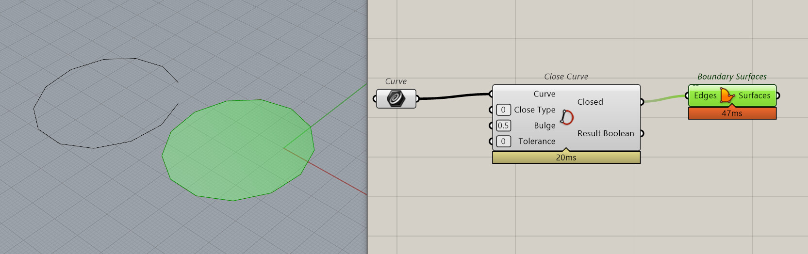

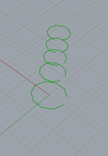

I cannot share the .gh file right now. Who knows about how to connect the end points of each point group to create a closed surface each(polygons)
Baris
3

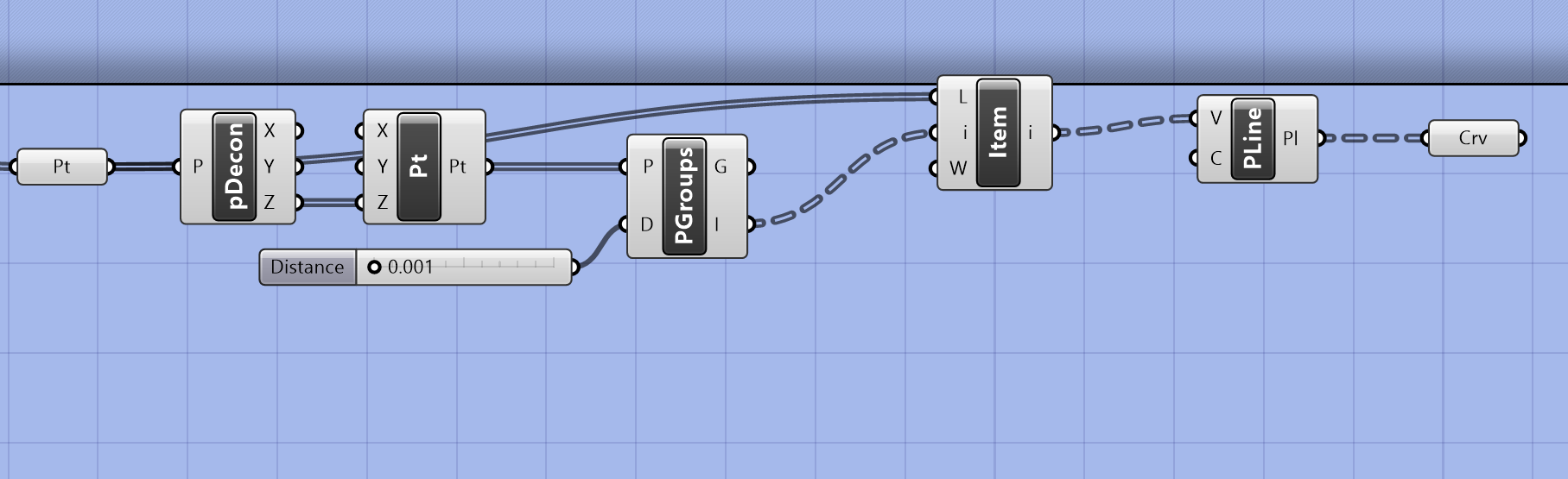

When you rightclick over the C on the Pline component, and set it to true, they should be cloesed.
ICHAN
(ICHAN)
4
Tried this and it works . Thank you.
