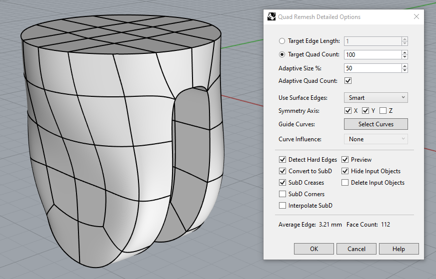

Hi Thomas,
I moved your “concept” NURBS geometry to the origin and ran _QuadRemesh on it. Usually it finds a nice subd topology to start with…
Thanks for giving it a go Jess. I see you opted for a hybrid approach.
Unfortunately not, no! I asked about such a feature some time ago, and it doesn’t seem like they are considering it for now.
I guess for me this would still be faster and more precise to do with Nurbs.
Yes, you can use Bevel kind of like edge filleting. The bevel distance gives you some control over the smoothing behaviour.
However, it’s as prone to produce undesired geometries, as it is to fail for polysurfaces. You often need to optimize or tidy up the geometry afterwards.
