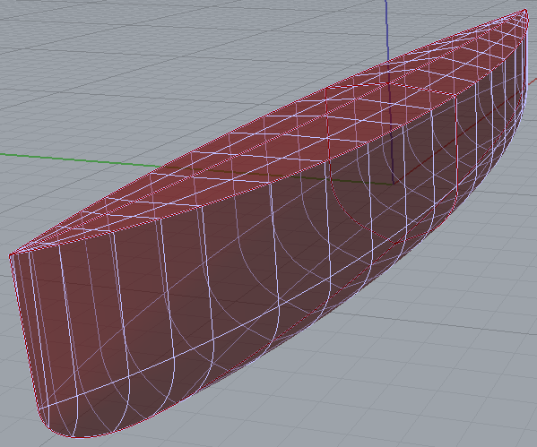

That’s fantastic! Well done. Will it work on a shape like this? To apply a ~3" radius to both sheer rails (the outboard edges of the deck). That deck consists of two surfaces that meet at a peak down the centerline, Curious to see the result at the bow? My past efforts with filet failed miserably on stuff like this.
boat_hull
boat_hull.gh (9.4 KB)
Happy New Year
I did not rewrite fillet logic from scratch. If Rhino can’t do it, Grasshopper can’t do it either (I tried, it doesn’t work). You’ll have to complain about this in the regular Rhino category. Then, once/if they fix it it’ll also start working for GH.
