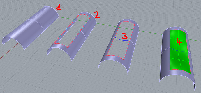

the main principle/logic is: given a Surface (1) make some slots in it (2) then draw some section curves (3) and finally create surfaces to close the slots you just created (4)
the Gh file you attached uses exactly the above workflow, leveraging on isocurves to determine the flow of the slots
the final step where you crate the surfaces to fill the slots is often performed through sweep2, but you can also consider Network Surface if you have more complex geometries
