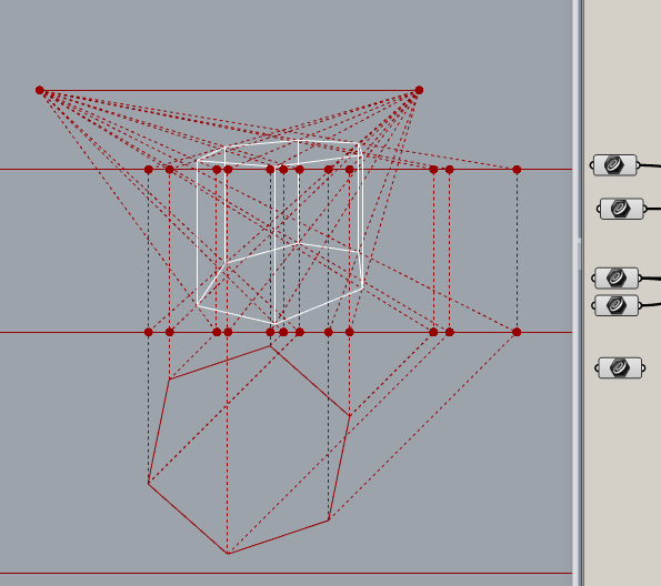

Hi! This post is less of a technical question, and more of a riddle for people who are interested descriptive geometry. A while ago I made this algorithm, just as a proof of concept, with a lot of hardcoded stuff in it:
detarminant.3dm (62.7 KB)
detarminant.gh (29.6 KB)
Now I am trying to make the approach more parametric, and so it works with many shapes. I am struggling to find a coefficient that would represent lens length for each given point at the same time, without looping based on one determined point.
Basic principal looks like this:
We can represent a line in a 2p perspective view, based on its height and plane view.
Here’s a demonstration for 2 lines.
The problem starts when i try to make more lines, or just points. I need some kind of coefficient value, that i struggle to find.
Here is an example where i use such coefficient, but i violate some of the rules of perspective, and get this strange result:
determinant2.3dm (54.1 KB)
determinant2.gh (42.7 KB)
I do it for fun, but i think it can be useful. Please share your thoughts on the matter.
Imagine using this approach being able to build isometry, 2 or 3 point perspective drawings for complex breps in a matter of milliseconds
My interpretation.
determinant2 a.gh (18.4 KB)
Nice attempt! 1Point perspective method. Looks similar to so called “Architects method”
Second track.
Two points.
determinant2 b.gh (18.5 KB)
determinant2 c.gh (17.1 KB)
Looks great! Thank you for input.
While i was looking for a coefficient for determinant method, I made this Radial method (Durer 1471-1528). I am not sure about 3pt though. Still want to find a solution for a determinant method
durer.gh (23.6 KB)
