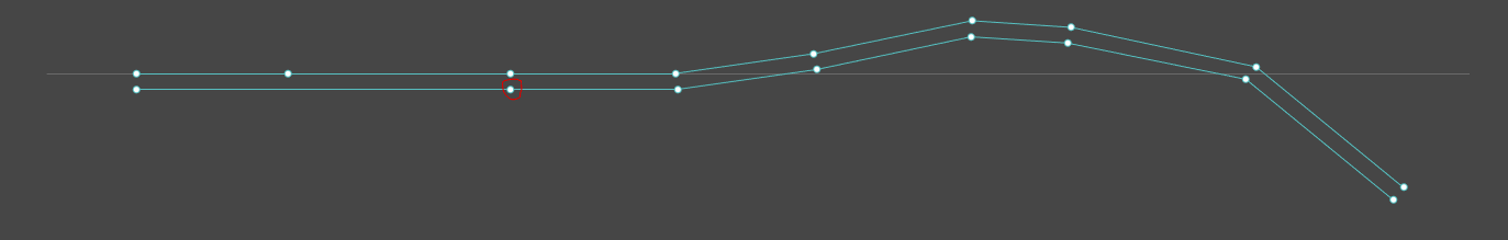

I expect that’s deliberate, it probably runs the input curves through the polyline reduction algorithm and if there are extraneous points within the user-specified offset tolerance, it removes them. Why would you use Offset>Loose on degree 1 curves, when Offset (standard) will give you the exact segment offsets?
I see it isn’t too reliable though, some points are removed and not others:
And actually the result is the same on the above test whether the offset is loose or not.
Well, I was trying to use Offset Loose to stop Offset from changing the curve parameterization (which is a bug):
