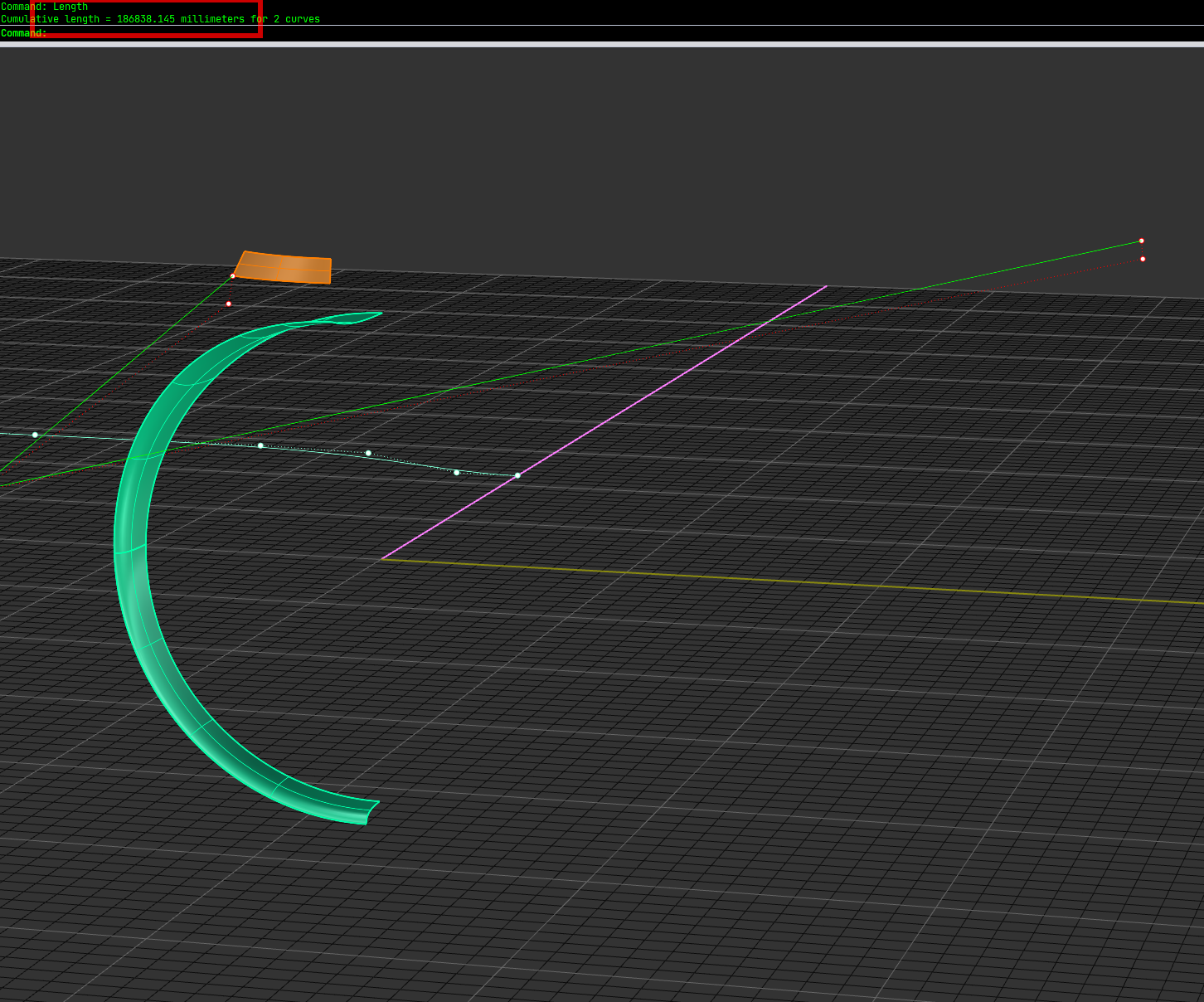

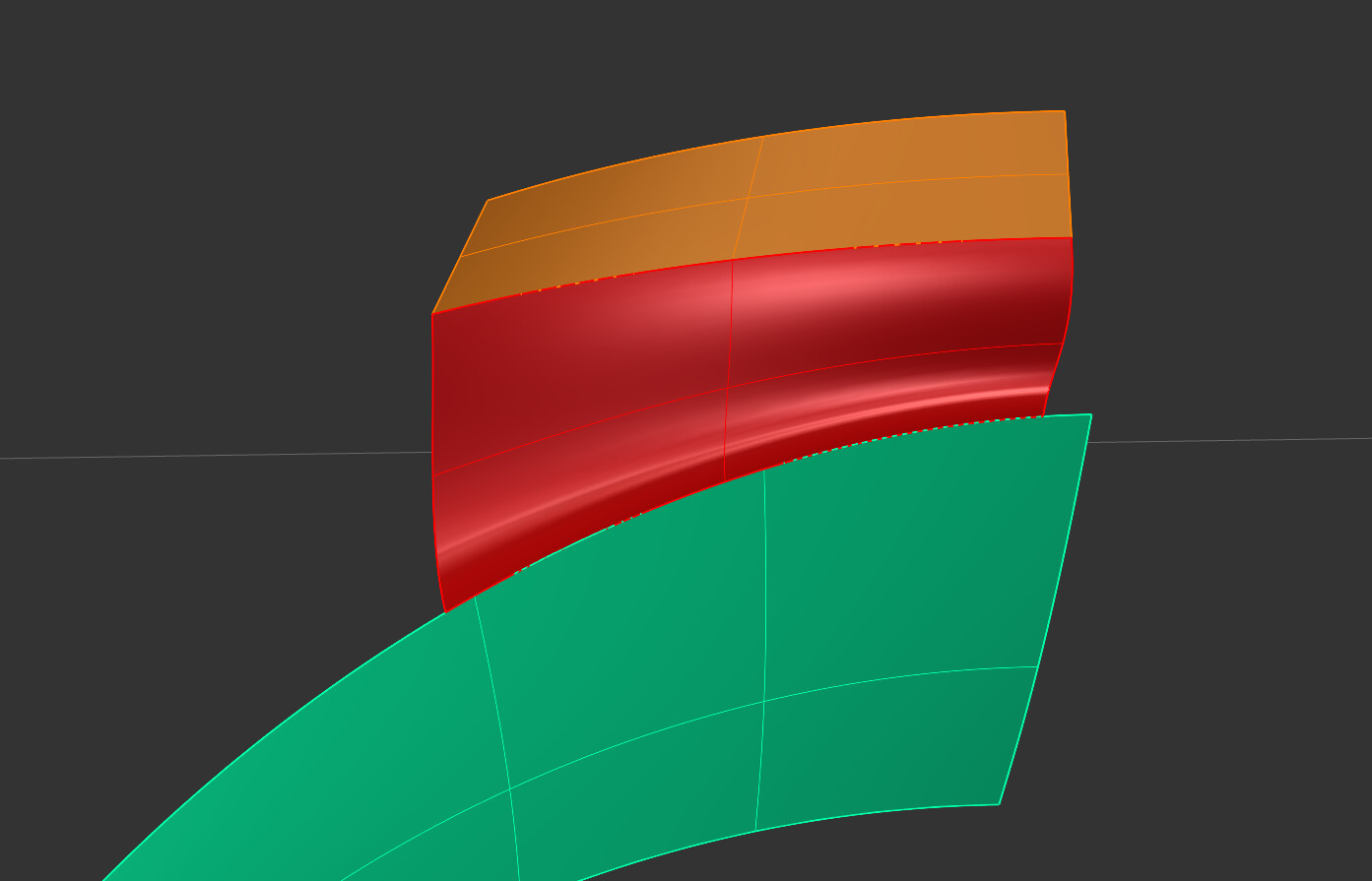

@Mikko just finished RH-53677 (@pascal tested). It looks like there’s still an issue with history updates. Here are the repro steps.
RH-53677 BlendSrf Edge Updates.3dm (255.4 KB)
  1. From the top viewport, move the last two curve control points closest to the YAxis by -1.
  2. This updates the green surface. Its edge is now longer, and the blend no longer matches the endpoint.
  1. Try to edit the blend. The selection location is offset from the cursor (red arrow). You cannot drag it to the endpoint anymore:
I hoped this fix would help with RH-65188, but _BlendCrv _Edges appears to suffer the same as it used to. Here are the repro steps.
RH-65188 BlendCrv Editing history messy.3dm (251.9 KB)
  1. This updates the green surface. Its edge is now longer, and the blend crvs have gone crazy.
  1. Try to edit the blend crv, but you can’t get it back to any kind of expected output.
Hi Eric - this seems OK in our latest here:
As does editing the blend - slid it in a bit here.
A couple of recent updates in this area- give tomorrow’s build a try.
Sorry, I forgot to say I’m on 8.0.23080.12305, which said it had RH-53677 (and is why I’m trying to move to the WIP yet again).
Is the blend crv fixed in your build as well?
Eric, I lied .
The fix was to ExtendSrf, to keep the domain constant, in this case the domain of the surface grows with a -1 move (I accidentally used +1 initially) so it is not ‘fixed’ cause it is a different thing… The blend ends on the same parameter but the domain has expanded slightly.
