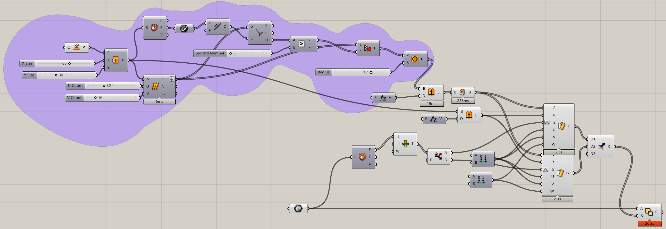

This turned out to be uglier than I had hoped. but it seems to work.
bb1.gh (356.8 KB)
Thanks. I opened your file and the last component split is not showing in rhino. I does not compute.
I’m using Rhino8 - when I loaded your GH file I got an error message about an obsolete component, so I’m not surprised you found a compatibility problem with my file. I’ll check on what the last component is and let you know. Right now my guess is that it is a BrepJoin.

The last component is SDiff - Solid DIfference.

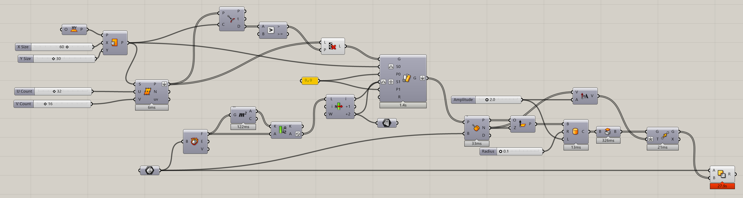

Mapping hole center points instead of cylinders would be an alternative:
bb2.gh (353.9 KB)
Ah yes, much nicer. Thanks for sharing.
Nice, thank you. It’s a clean method. May i ask you something: you can see in the file that i did Cull Pattern for 4 edges. I was wondering, is it possible to only Cull 2 edges not 4 ? I tried something but it failed. You can see in the image bellow where i tried List Item and select the 2 edges to cull, it doesn’t work. You look genius level, if you could help. Thanks.
You can calculate the dot product between the edges and x or y vector…

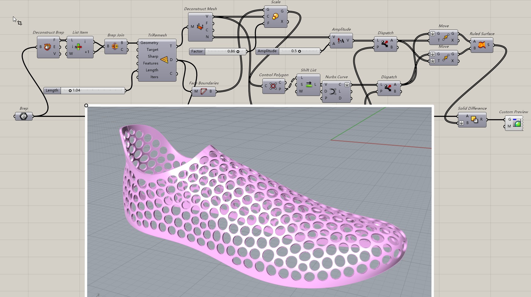

Provide another perspective for your reference.
SolidDifference.gh (345.5 KB)
Very interesting solution - thanks for posting it. I’ve made a number of 3D printed objects with various types of holes in them, but never used meshes for any of them. So I have some questions about your method:
  1. I thought Trimesh used triangles for the mesh, but your MEdges shows hexagons and pentagons, not triangles. Where did the triangles go?
  2. Your Rulsrf produces open cylinders, yet SDiff treats them like solid cylinders. I thought SDiff required solid cutters, not open ones. Is this a new SDiff feature?
  3. Is the CPoly component part of Trimesh? I’ve not seen that component before. Plus, at least in this example, the Shift component isn’t needed if the Nurbs Periodic parameter is set to True. So it’s not clear to me what the Shift is actually shifting.
Finally, I like how brief and concise your solution is, but I’m somewhat stuck on the hexagon/pentagon issue. I understand why the pentagons are there (thanks to Bucky), but the net result is differently sized holes. Maybe this is just a nit that normal people wouldn’t notice. But if the objective was window glass for a big building it seems tome couldn’t it be a deal breaker?
It’s still here, but this case uses the vertics of the triangular mesh as the center points for scaling the hexagons and pentagones.
BooleanDifference, like in Rhino, does not require a fully enclosed object to be executed. For details, pls refer to the detail in Rhino Help and Grasshopper Help
No, Control Polygon is native component,
Shift is used here to remove overlapping points, more details are here :backhand_index_pointing_down:
