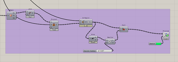

Another problem I seem to find difficult to find a solution for…
I want the floor in it’s 3 parts projected onto the wineglass, so that I can give the individual parts different colours in a later render. I want to see how a potential floor is reflected on a wineglass that is painted in the back of the painting, giving the tiles slightly different shades. I managed to project curves onto the glass, but seem to fail with either surfaces off breps…any suggestions anybody?
Thanks a lot, Ekke
Hi Ekke,
here is a bit of a hack, but I think it is a great starting point for improvement:
Wineglass_Brep_surface.gh (252.6 KB)
The script splits the surface, then filters by area. This is of course not the most elegent way but it works in this example. One proper way to do it would be to project a line from the center of each tile in the same direction and then test for intersection.
