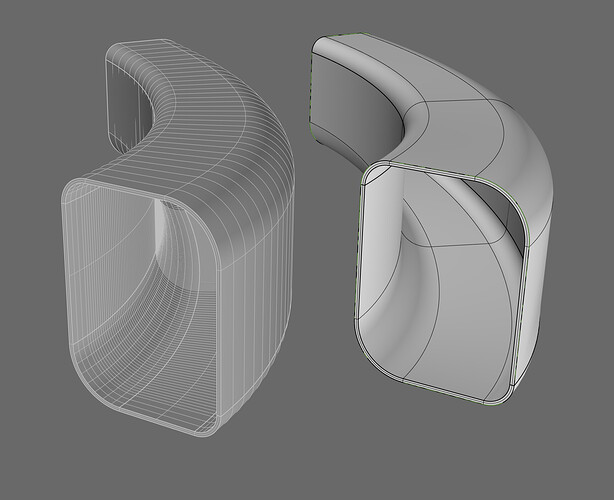

You can see a closed shape which is the result of several trimmed surfaces degree 1. I have dupborder from all surfaces. The curves of the top sloped surfaces are planar but degree 3. I know i can clean the curves but still the results are not the expected.
The closed shape seems to have a lot of unnecessary isocurves and looking at problematic section curves at least some of them are almost coincident with isocurves. Not sure if this is really a problem but I wouldn’t be surprised.
I rebuilt your base shape. You can see the curves I used for the Sweep1 in the file attached. The rail is a rebuilt curve with just 6 points. Not sure if this is an acceptable result for you but less control points generally lead to better results downstream… I offset the Sweep1 polysurface by 0.15 inwards and the result is a closed polysurface.
Orange curves with a lot of control points especially on the inner curves which may be a result of a bad offset. Green curves all closed and planar.
planar.3dm (1.7 MB)
Based on my result I’d say the way you built the solid shape is the problem.

I created this shape with the following order:
First i sweep two closed curves, both contained 4 straight edges with a fillet at the corners.
After i offset the surface.
That’s why the inner srf has so many cps.
Maybe it would be a better workflow to offset the starting closed curves and sweep them along the same path.
But anyway the intersection of anything with a plane should be planar. Even in the 9th digit. I know that mathematically this is not possible in the 9th or whatever the document precision is digit, but the rhino command should after compute the mathematic intersections to project them automatically to the plane. This what I am doing manual to solve the problem.

Ok, your curves are actually ok. But something went wrong on the creation of the surfaces.
How did you create the offset?
_OffsetSrf
I recreated your Sweep1 and I get a much cleaner looking shape.
better_solid.3dm (1.7 MB)
Yes right now me to. Telling the truth I don’t remember what I’ve done. The main question that make me remember also this problem was the extract border function from planar srf, which again result non planar ( yes in the ninth digit) curves and also degree 3 curves even if the srf is degree 1 with only straight edges.
