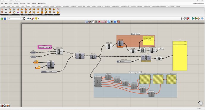

Boolean operations in Grasshopper usually lead to “random problems” like the following. Sometimes you can find some workaround by dividing the boolean union into pieces and then joining all together, but this time I failed… Please, would you help me?
I have some larger sketch that generates different geometries for 6-arm Breps. To illustrate this weird behavior I´ve prepared a minimal internalized version SolidUnionProblem.gh (12.6 KB). However, whereas it works nice for most geometries, for example (select “Good” in “Select lines” selector):
in some other, it totally fails (select “Bad” in “Select lines” selector):
Thanks a lot in advance!
I’ve played around with tolerance a bit and the bad curves result in closed breps if the tolerance is doubled if the initial pipes aren’t capped.
SolidUnionProblem.gh (24.5 KB)

Have you thought of using Multipipe?

The crossings look better if you divide the lines.
Not sure this will be robust in any way, but at least I gave it a try…
The main idea is to reorder the tubes and process to boolean operations in groups where I think success is more likely to happen.
Both examples work (with bad/good input), with tolerances set as default (0.001 in distance, and 1.0 in angle). Could be interesting to check for more cases, although the outcome is still likely to be bad.

The two tubes which are colinear could be combined into one line or poly line first.
Does this help?
Added FlattenTree before BrepUnion. Maybe I misunderstood.
But it worked for me.
