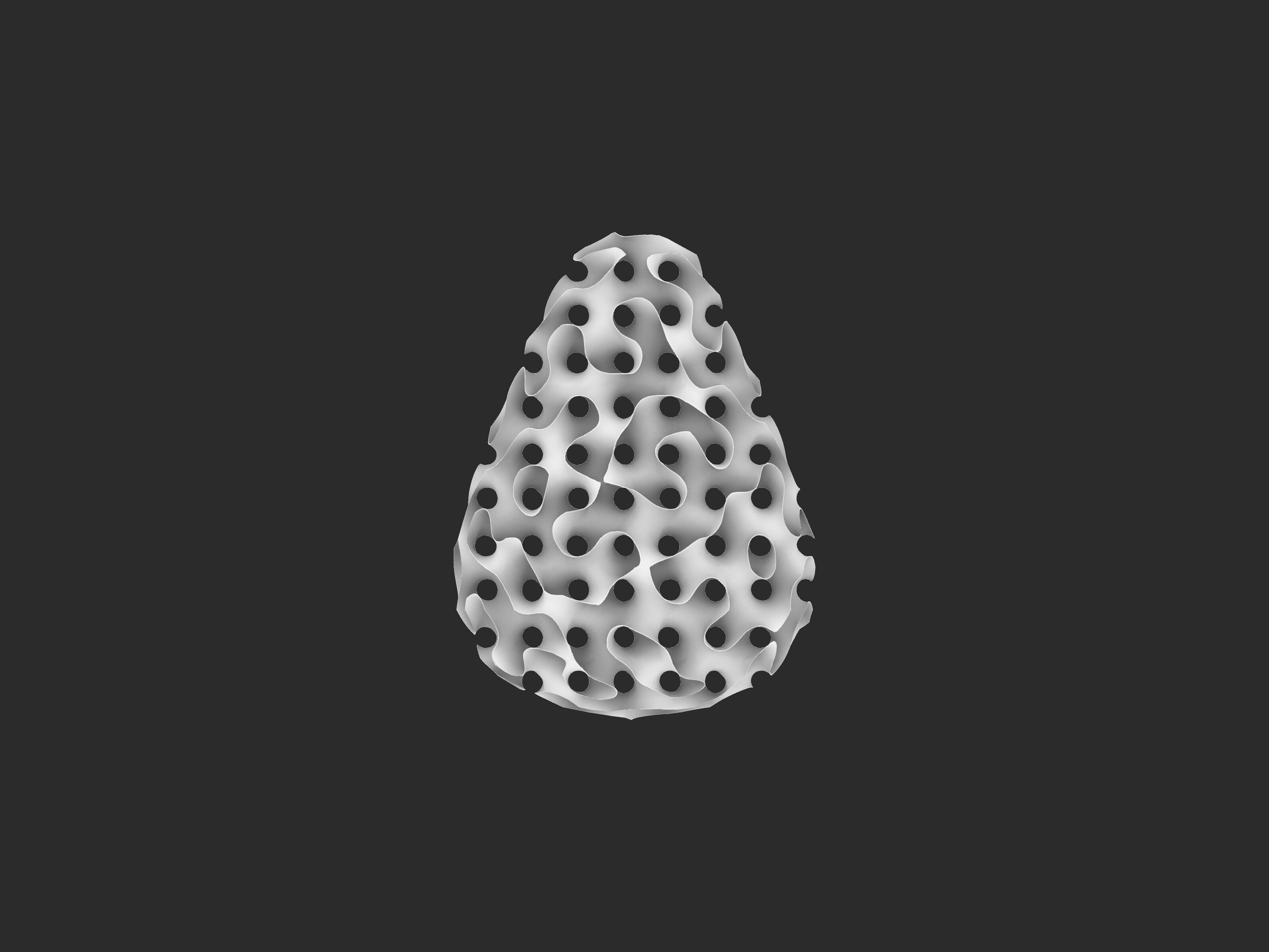

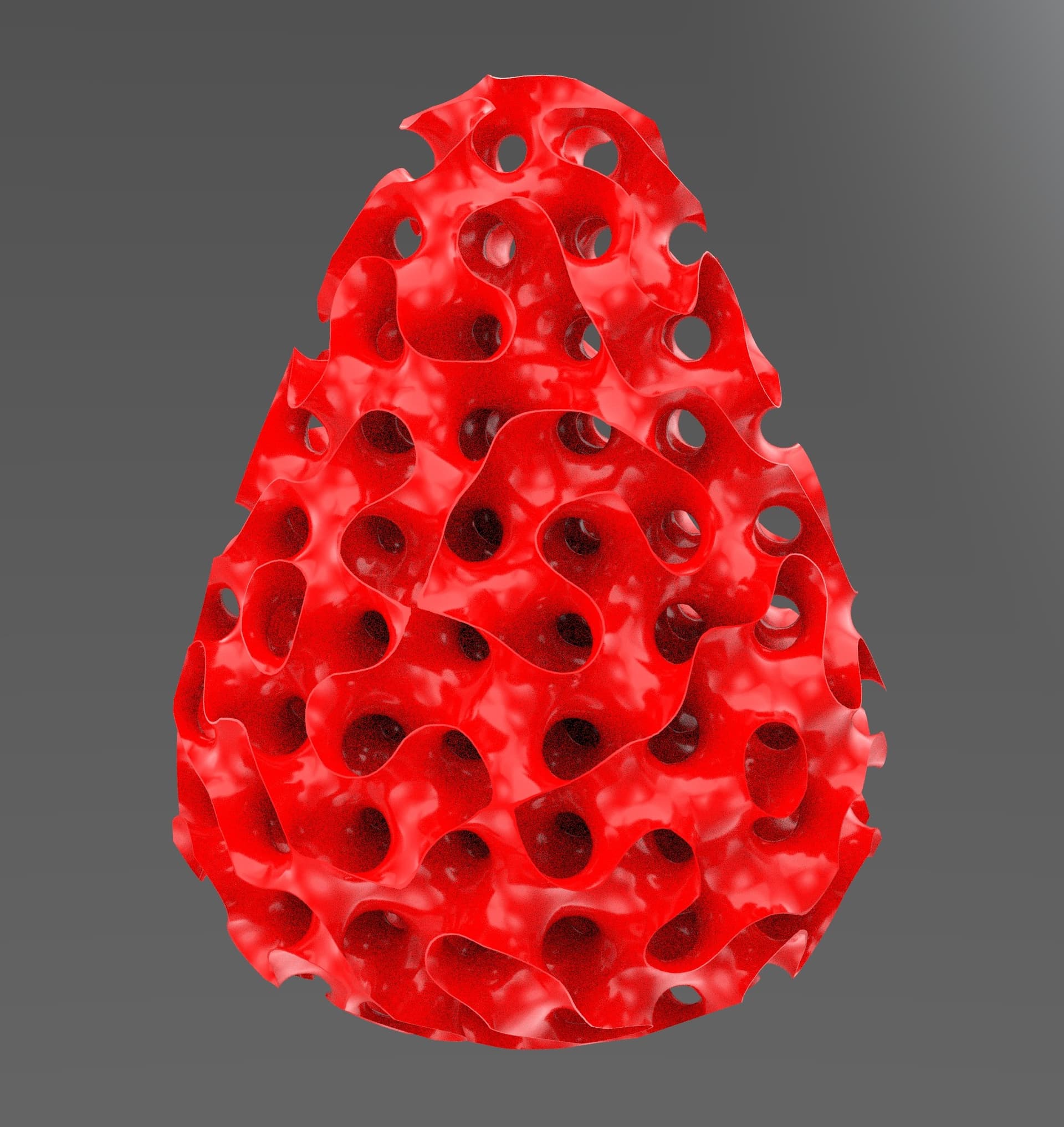

Is there a reason why, at some angles of rotation, you can see straight through lots of holes?
As if there’s some alignment happening.
it looks like the shape is based on sine functions which simply perpetuates everything orthogonally in xyz directions
https://www.researchgate.net/publication/50376580_From_three-dimensional_weavings_to_swollen_corneocytes
You can fit a periodic packing of infinite rods very well in the spaces either side of the gyroid surface. These channels show up as clear views through.
(Actually the view channels are larger than the rods in the weaving, since they are allowed to intersect with others in the other directions)
I dont remember clear, sorry…(maybe)
1)Yes, totally, that came out of the algorithm.
I should open it and see in detail, because it is so…
but if you see the minimum surfaces (image) you can also easily see that pattern in some way sometimes orthogonal in some sense.(““symmetry””, think i !)

The channels in the gyroid run not just in the orthogonal directions, but also in the 4 tetrahedral directions

There are so many wonderful things to explore about the gyroid. Alan Schoen, the guy who first discovered it is still around and has this amazing page about its history
