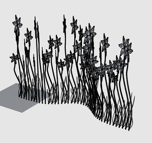

When exporting to dwg or dxf my block instances all get piled in one place instead of where they are placed in my rhino file…is there a way to avoid this ?

when I re import the exported file the leaves are mostly clustered at one point

most of the blocks(leaves) have reverted to the position of the original block definition at the base
See this as well when opening in Autocad. Guessing it has to do with the non-uniform scaling but will have dig into it more, not seeing any existing youtracks on the subject.

yes, the non uniform scaling is the cause, I believe…I just flattened all the leaves in the Y direction and the exported dwg file exhibited the same problem whereas the unscaled leaves (new) all appeared in the correct place in the dwg file
If I apply your Push Content to the adjusted leaves then the export works correctly

It looks as if this problem has been solved…here is a GH created distribution of block instances from a single block definition that have been randomly scaled and rotated…they were baked,exported to dwg and re-imported…everything is in the right place and the one block definition is intact with all the instances
