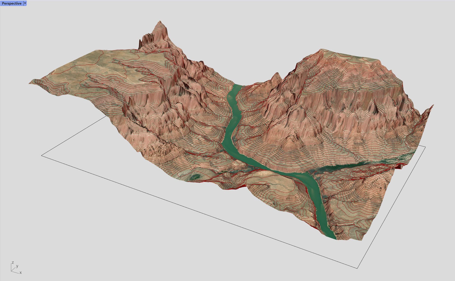

Hope these help get you started - I usually convert the rasters to points and export them as a CSV to read back in GH and get a nice clean quad mesh out - they get pretty gigantic though, depends how many millions of points you’re willing to deal with, though I find it a more exciting way to heat my house with energy prices the way they are!

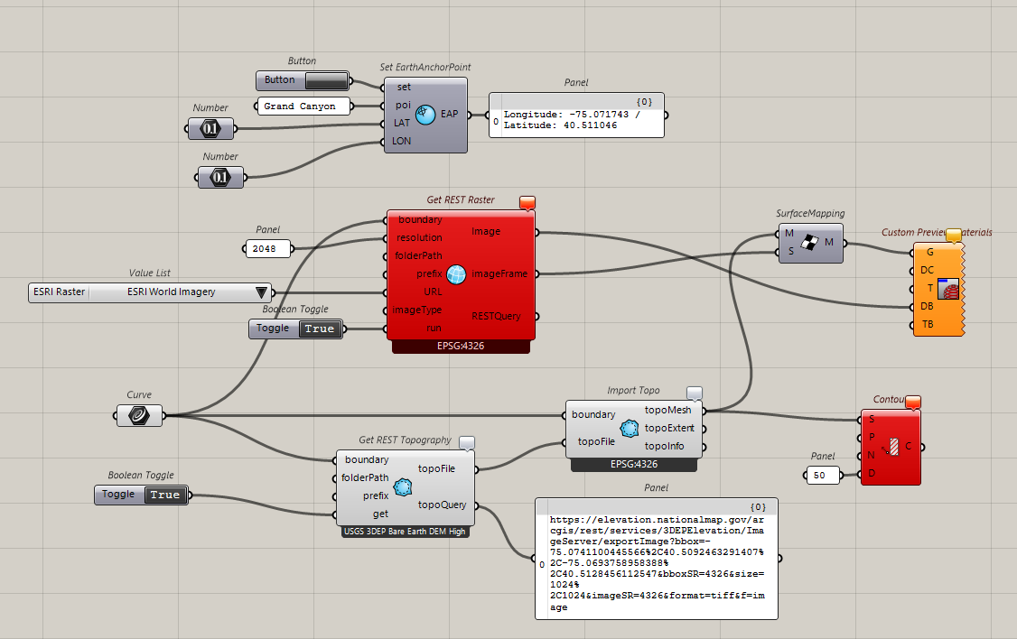

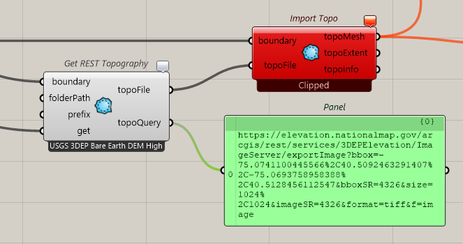

If you are looking for a more programmatic approach, the USGS has an ArcGis Rest Service for their 3DEP product which will give you a DEM tif. The highest level of resolution will vary by location, but some places are near 1m. The nice thing about this approach is you can control the size of the resulting mesh with an arbitrary boundary for your area of interest and a selected image resolution.

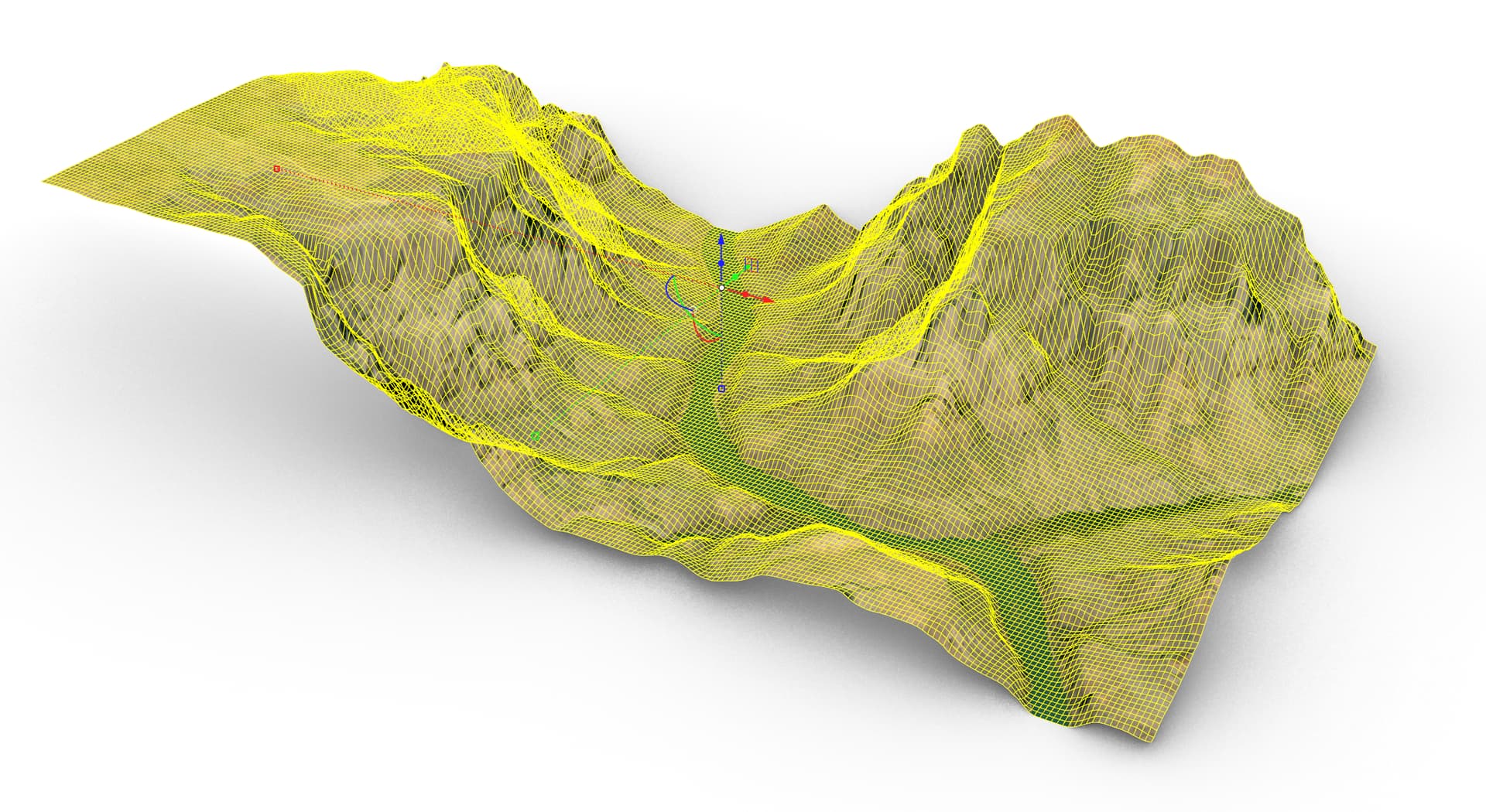

Heron has component called RESTTopo that will do just this in GH. Once you set the EarthAnchorPoint with the SetEAP component, just give it a boundary and select the 3DEP service from the component menu and you get back a DEM tif that you can plug in to the ImportTopo component to generate the mesh. If desired, you can also grab satellite imagery with the RESTRaster component which you can then map to the topo mesh with Human components. 20231116_3DEP Topo Import.gh (26.1 KB)

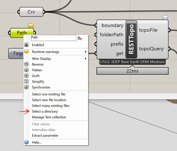

Hi @Andrew_Turner ,
That’s a default folder that populates in the component when I initially place the component on the canvas. Change it to one that makes sense for your machine and it should work.
-Brian
There are a few ways to set the folder to which RESTTopo will download the DEM tif. The folderPath is just a string (text) input, so if you right-click folderPath on the component, you’ll see a menu where you can set a folder path specific to your machine by typing in text. Otherwise, GH has a File Path component which, again, if you right-click you can “Select a directory” and it will help you navigate to an existing folder on your machine. Finally, if you drop a new RESTTopo component on the canvas, it will auto-populate with a temp folder specific to your machine.
I’m new to Grasshopper, and I’m running into an issue where the GH file in this thread “20231116_3DEP Topo Import.gh” is reporting that the Surface Mapping, and Custom Preview Materials plugin is missing. Where do I go to download these two plugins?

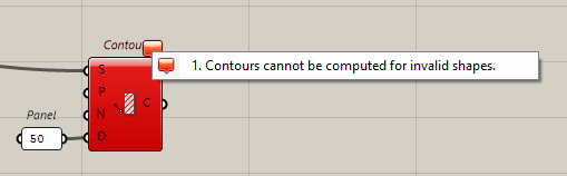

I’m thinking it may be a units issue. For instance, if your boundary curve is 1,000 x 1,000 and units are set to millimeters, you will get errors from the services because your boundary is too small. But if you set Rhino’s units to meters, 1,000m x 1,000m should produce results. After changing units in Rhino, make sure to recompute the definition.

I usually bake the texture mapped mesh to Rhino using other Human components. You can create a Rhino material with Create/Modify Materials then set up assignment of the material to the mapped mesh with Create Attributes. Finally bake the mapped mesh with the set attributes using the Bake component. I haven’t used Blender before, but you might try exporting as OBJ.
