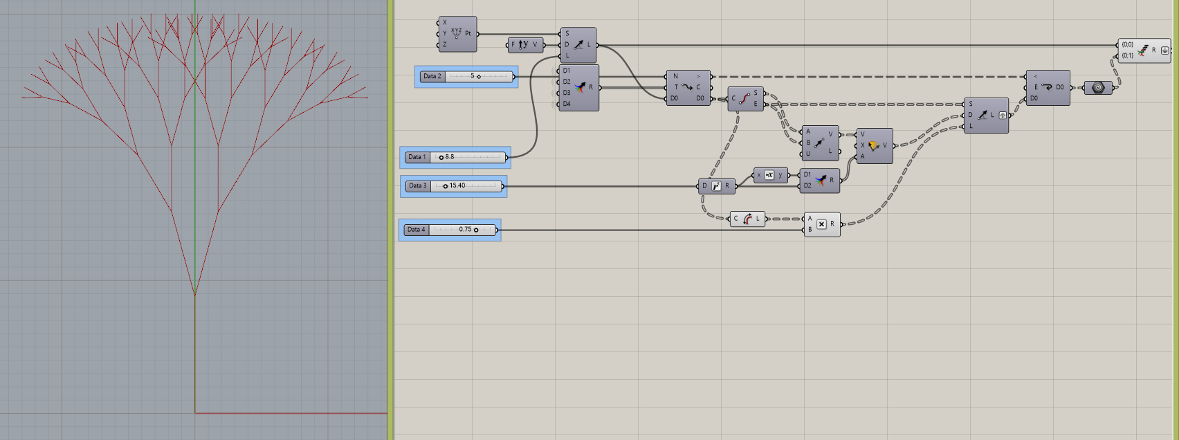

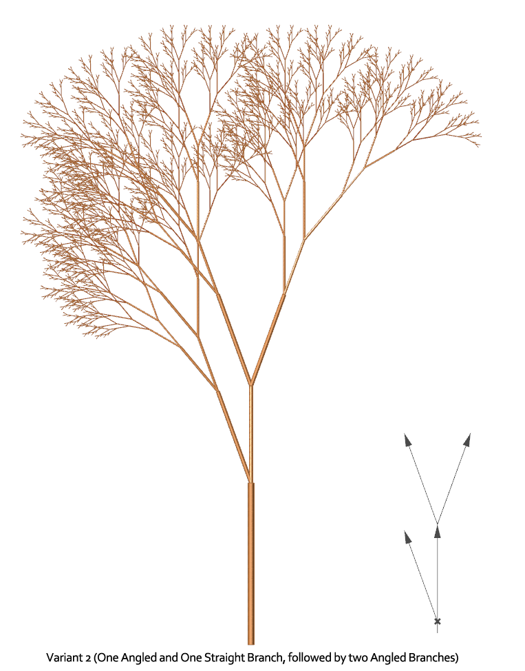

I was able to replicate the most basic of examples, but I am afraid I was not able to achieve the specific pattern depicted in this image (also created with Anemone within GH):
The logic here has 2 steps, first it branches into an angled + straight line and then into two angled lines.
I can’t wrap my head around how to incorporate this double step logic…

Your def is not an L-System, it’s just a recursive system. An L-System has a grammar (symbols and rules) and a grammar interpreter (usually geometry), which is optional. Recursiveness basically means repeating the same process using the output as input (or calling itself into the process).
What you want to do would be very easy with an L-System, because a single symbol can be interpreted as those four lines, for example:
Simbols:
F (line), +(right turn), -(left turn), (open/close branches).
Rules:
F = F[+F][-F]-F <-this creates the 4 lines.
Initial axiom:
F
Iteration 0: F
Iteration 1: F[+F][-F]-F
Iteration 2: F[+F][-F]-F [+ F[+F][-F]-F ][- F[+F][-F]-F ]- F[+F][-F]-F
This will create one tree where each line (F) is replaced by those four. In the next iteration, each of these four lines will become new four lines, and so on. That’s how L-Systems work, by replacement, not by addition.

Ah, thanks Dani. I should have said, “a translation from an L-System”.
I think I prefer to stick to geometrical procedures instead of using the L-System notation though.
I checked the def you modified, but I think you misunderstood me. Here there are 4 branches starting from a single point (in the smaller branches) and in the bigger ones there are 9 starting from the same point. In my examples goal there is always 2 branches starting from a single point.
