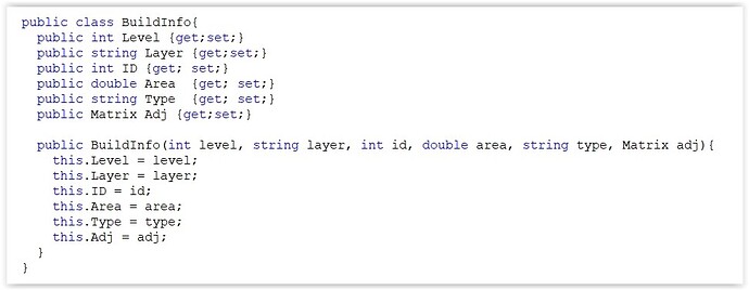

I’m working with a very long definition and finding the need to recover metadata from much earlier. It’s not my literal example, but imagine a file that first generate a six-sided die, complete with pips, and then much much later wanted to know which side of the die was closest to another object.
My mental model is to attach some kind of tag to each face of the die when it is created, then find the closest face later on and recover that metadata to know what side it is, regardless of whether it’s been rotated or whatnot in the interim.

Unclear (a bit) it is … but in general the orthodox way to deal with “similar” situations is to define a custom Class with suitable for the scope properties (of any type and/or any type of collection [ i.e. Lists, Arrays, Tuples, cats. dogs etc etc], populate accordingly a List (i.e. create a List of items of the type defined via the Class) and then query (LINQ) the List with any way imaginable:
For instance: given a List of Breps find Faces, Where they are planar (or not), Where their edges blah blah, Where their area is within some range, Where their orientation is within some other range, Where some property is this or that, then OrderBy this or that way, then GroupBy … blah, blah…
All the above are very easy with code (C# for me) … and rather impossible without (most notably if the queries are nested and/or are “custom” [as happens in real-life] for a given Project). Unless there’s some plug in around that does that (but i don’t work with plug-ins and thus I have no idea on that matter).
Thank you for deciphering my unclarity! That sounds exactly like what I need. C# and LINQ are fine, though I have not worked with them in the Grasshopper context. Sounds like a fun project.

Kinda (I’m in the AEC market sector thus all my real-life cases are AEC oriented):
  1. Having some Breps on hand define a test Class:
  1. Populate randomly a List (of the custom type) and write several LINQ (Lambda syntax shown) queries in order to get the gist of the whole thing:
