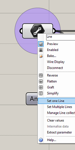

When you choose ‘Set one Line’ in the line’s context menu, Rhino asks you to pick the two points between which you want to have a catenary. And then you are able to use the two sliders to shape a catenary you like. To get a curve in Rhino, you need to select ‘Bake’ in the catenary’s context menu.
