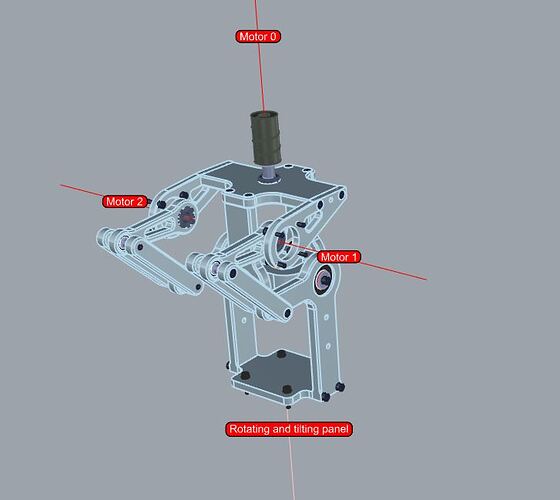

We are trying to animate a mechanical system with two independent levers actuated by two independent motors. We have used IK using a point following a path curve but are stumped when the dependecy path is split in two.
Included is the model.
Would anyone have a suggestion?

The IK structure in your 2.0 model is off to a good start. For object “suport capteur” though the pivot is at the wrong place. It should be located where the spinning actually happens (coordinate 0,0,0 in your model) and made a ‘Hinge Y’.
Secondly you overlooked that the distance between object “suport capteur” and the point “point” on the path cannot remain constant. So I added an auxiliary point object “aux” telescopically to the chain and constrained it to the diligent point object “point”.
test anim6 001.3dm
So far Bongo 2.0 IK. It’s nice you had a go with Bongo 3 WIP too!
The issue of the diligent point object “point” which needs to be able to move away from the “suport capteur” remains. So again here the aid of an auxiliary object is needed. It is connected to the “suport capteur” with a slider and then ‘Grasped’ to the point “point”.
test anim6 WIP.3dm
I found the model is slightly misbehaving. The “Fourche” at the top is faintly tilted at the end of the motion. It can be cured… test anim6 WIP 001.3dm… by disabling rotations X and Y of the “Fourche” in it former IK joint properties panel.
