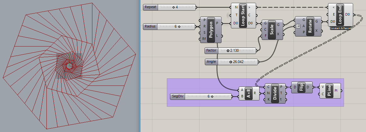

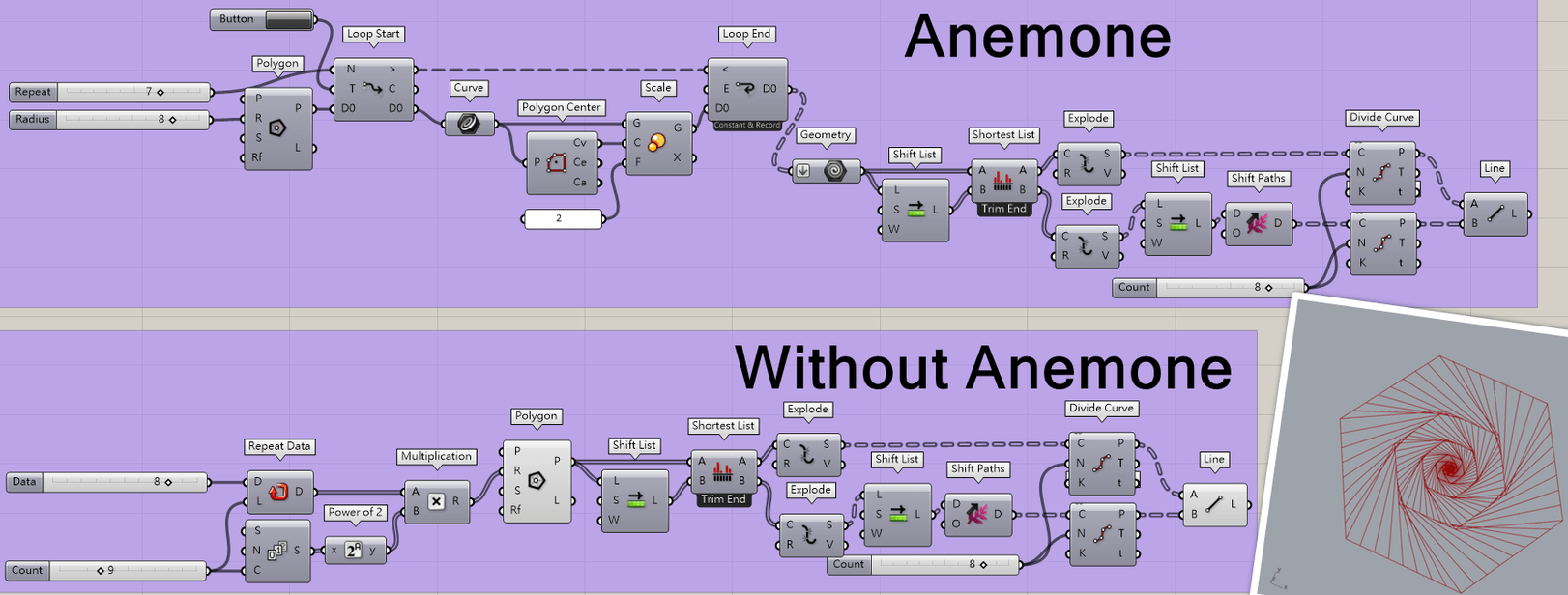

I have created a geometry shown in the picture in gh manually by scaling and shifting the list. I thought it could most likely work with Anemone. It seems like it is almost there, but I am not getting the lines between polygons for each iteration. Why is that?
Attached are both manual script and anemone version.
