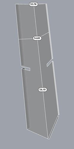

  2. In the below image the object has a non-orthogonal normal for one surface, and an orthogonal normal for the other. Also, the top edges are orthogonal.
It makes sense why the TwoObjects option produces a different result (54.19) than the same command snapping lines (53.78) at the top of each surface. But I experimented a bit by slicing each surface with a plane perpendicular (extruded along normal) to the large surface. The resulting intersecting lines produce an angle of 54.05. My question is, why wouldn’t this have the same result as the TwoObjects option?

Hi Nick - I don’t know how you are getting the lines on the surfaces, but I think the way to check is to measure the angle between two normal lines on the surfaces - if the surfaces are planar, then the angle should be what you get from querying the planes. ’
If you make a line on one plane that is perp to the common edge of the planes, and Pull that to the other plane (or extrude normal and Intersect) then you should also get the same number from Angle… If the line is not perpendicular to the common edge, then you would not get the same answer as from querying the planes.
Does that make sense with what you see?
Kind of interesting to see what happens with non-perp lines. Try making a line that is not perpendicular to the common edge, on one surface, then repeatedly Pull the the line, then the result of the pull, then the result of that Pull, back and forth between the surfaces - the result is a fan shaped series of lines that all have their outer end points on a line in each surface that is perp to the common edge , and these two lines are at the angle between the planes.
The red line is the starting line, the black lines are 30 degrees apart, like the planes.
Thanks for the note Pascal. The lines normal to each surface gives the correct angle, indeed (which makes total sense). I found the intersecting lines shown in the image by intersecting both surfaces using a single plane normal to only one of the surfaces, thereby making a mistake.
