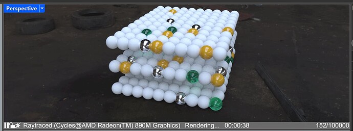

AMD HIP Rendering on a 9070XT is not actively rendering

Above is my SystemINFO for this computer that I am having problems with.
I had recently gotten an AMD RX 9070XT and had assumed that it would be compatible with AMD HIP with the latest driver. Fast forward to now and many clean driver installs, Rhino isn’t attaching to the GPU for any rendering workloads. CPU Rendering works but it is significantly slower. I wonder if it’s and AMD Driver issue vs Rhino needing to perform an update to get the new Card ready for rendering. I could be very wrong and the issue could just be on my particular setup. Thanks!
Are you testing with just a simple box in the default template upon opening Rhino and testing?
If you could
  1. In Tools > Options > Advanced search for VerboseLogging and set to true
  2. Restart Rhino
  3. Do a test render with just a simple box after starting Rhino
  4. run the non-autocompleting command RhinoCycles_ShowLogs after a render attempt and post that here
Thanks in advance
I have the same problem, I’m using a 16GB 9060 XT.
It doesn’t render. The only way it renders anything is using Legacy Rhino Render, but with this it only uses the CPU.
I tried doing what you asked the other person to do, but I couldn’t get the RhinoCycles_ShowLogs part. How do I do that?
Any ideas on how to fix this?

I also just realized that the WIP version of 9 was recently released. I downloaded it just to try it on this one and the exact same thing happens.
My bad, I typoed. It is RhinoCyclesShowLog.
I assume you already enabled the verbose logging?
==============================> OnLoad (Core)
21/09/2025 5:03:37 a. m. :: 00:00:00.0001072 (Core) |> Running on Windows21/09/2025 5:03:37 a. m. :: 00:00:00.0000008 (Core) |> RhinoCycles OnLoad entry21/09/2025 5:03:37 a. m. :: 00:00:00.0000406 (Core) |> RhinoCycles OnLoad: RegisterContent start21/09/2025 5:03:37 a. m. :: 00:00:00.0037300 (Core) |> RhinoCycles OnLoad: RegisterContent end21/09/2025 5:03:37 a. m. :: 00:00:00.0006383 (Core) |> RhinoCycles loaded in: 00:00:00.004412021/09/2025 5:03:37 a. m. :: 00:00:00.0000001 (Core) |> RhinoCycles OnLoad exit21/09/2025 5:03:37 a. m. :: 00:00:00.0003490 (Core) |> InitialiseCSycles entry21/09/2025 5:03:37 a. m. :: 00:00:00.0275405 (Core) |> InitialiseCSycles exit21/09/2025 5:03:37 a. m. :: 00:00:00.0007663 (Core) |> Finding render device with 021/09/2025 5:03:37 a. m. :: 00:00:00.0022995 (Core) |> Got render device ccl.Device: AMD Radeon RX 9060 XT (Hip), Id 0 Num 0 UiName HIP_AMD Radeon RX 9060 XT_0000:03:00 DisplayDevice False21/09/2025 5:03:37 a. m. :: 00:00:00.0012881 (Core) |> RcCore SetupProcessStartInfo entry21/09/2025 5:03:37 a. m. :: 00:00:00.0000110 (Core) |> RcCore SetupProcessStartInfo C:\Program Files\Rhino 8\Plug-ins\RhinoCyclesCore.dll21/09/2025 5:03:37 a. m. :: 00:00:00.0000085 (Core) |> RcCore SetupProcessStartInfo exit21/09/2025 5:03:37 a. m. :: 00:00:00.0977835 (Core) |> Finding render device with 021/09/2025 5:03:37 a. m. :: 00:00:00.0000633 (Core) |> Got render device ccl.Device: AMD Radeon RX 9060 XT (Hip), Id 0 Num 0 UiName HIP_AMD Radeon RX 9060 XT_0000:03:00 DisplayDevice False21/09/2025 5:03:39 a. m. :: 00:00:02.4765935 (Core) |> RhinoApp_Initialized
Yes, I’ve enabled it.
I can’t run the command right after trying to render anything, because if I stop rendering, the program dies and doesn’t respond again. I have to end the task. And sometimes when I stop rendering and then end the task, my PC starts crashing and I have to restart it.
I’m attaching an extra image to complement the others posted so you can see how the GPU behaves when “rendering.”
The log says the HIP device is identified and is being used.
I my first reply I asked if this also happening with a default scene to which only a box is added? Does that work or does that also give you problems?
If it is this specific 3dm model you are trying to render that isn’t working please share it with us at tech@mcneel.com
I did it just as you said to do, in a new scene, I made a small box to render and it fails anyway
Instead of Rhino Render use Raytraced, then run the RhinoCyclesShowLog command once it is clear the rendering doesn’t start in the viewport. Raytraced uses the same rendering engine as Rhino Render - the logs will hopefully give some more info here.

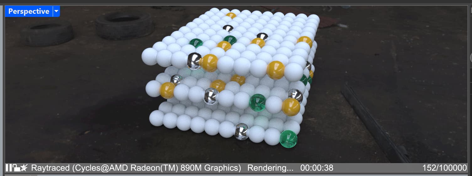

This renders fine on an AMD GPU with architecture gfx1150, one step down from gfx1200 that you have.
so currently stumped :man_shrugging:
This means that the problem is only with the latest generation AMD GPUs, GFX1200 and GFX1201.

Fixed by fully reinstalling the AMD Pro Drivers.
Well “fixed”, I can compile the kernels fine now but the render window stays blank and the program crashes when stopping the render, both in Raytraced view and the render window.
