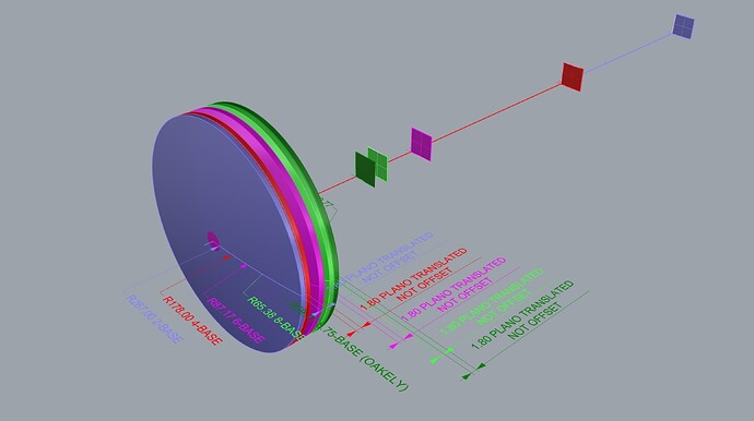

For the outer (convex) surface of the lens, r = 523/base curve #
So for 6 base, 523/6 = 87.167mm
For optical purposes, it’s important that lenses may be translated in space, but they mustn’t be rotated in relation to the direction of the line of sight. In pictures:
If you want a high wrap, decentered lenses are available. You still have to keep the LOS straight ahead!
