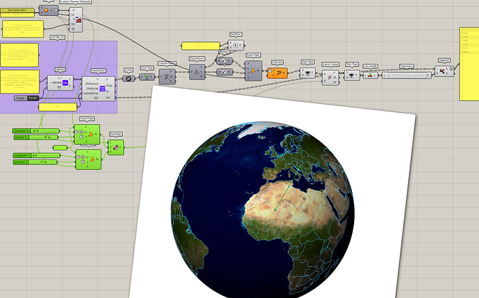

I have the coordinates of two points on earth. I need to find the line that connects those two points on the planet. The line will be extended till it find itself again. Meaning I will get a section of the earth defined by an elipse that touches those two points. The challenge comes here:
I need to find which countries the line crosses. So far I think I know how to get the line that crosses two points on a sphere. So I am guessing this is not a “model” task, but a mapping one and finding the countries through a texture of the planet applied to the sphere in rhino.
What It could be easier is to have a 3d precise earth model in Rhino an avoid texturing. I found bunch of them made with polys, but I guess to find intersections and angles on Modo (in my case) will be a hassle.
If anybody has a tip or a idea of how to do this or where can i find a precise model of the earth in 3DM that might help.
The borders of earth are put on a sphere with a given radius.
I also use Custom Preview from Human to get a textured earth.
Image from
I trace a Geodesic between the 2 points and search intersection. To have all the intersections change Rhino tolerances to 10 to intersect geodesic and borders (polyline).
